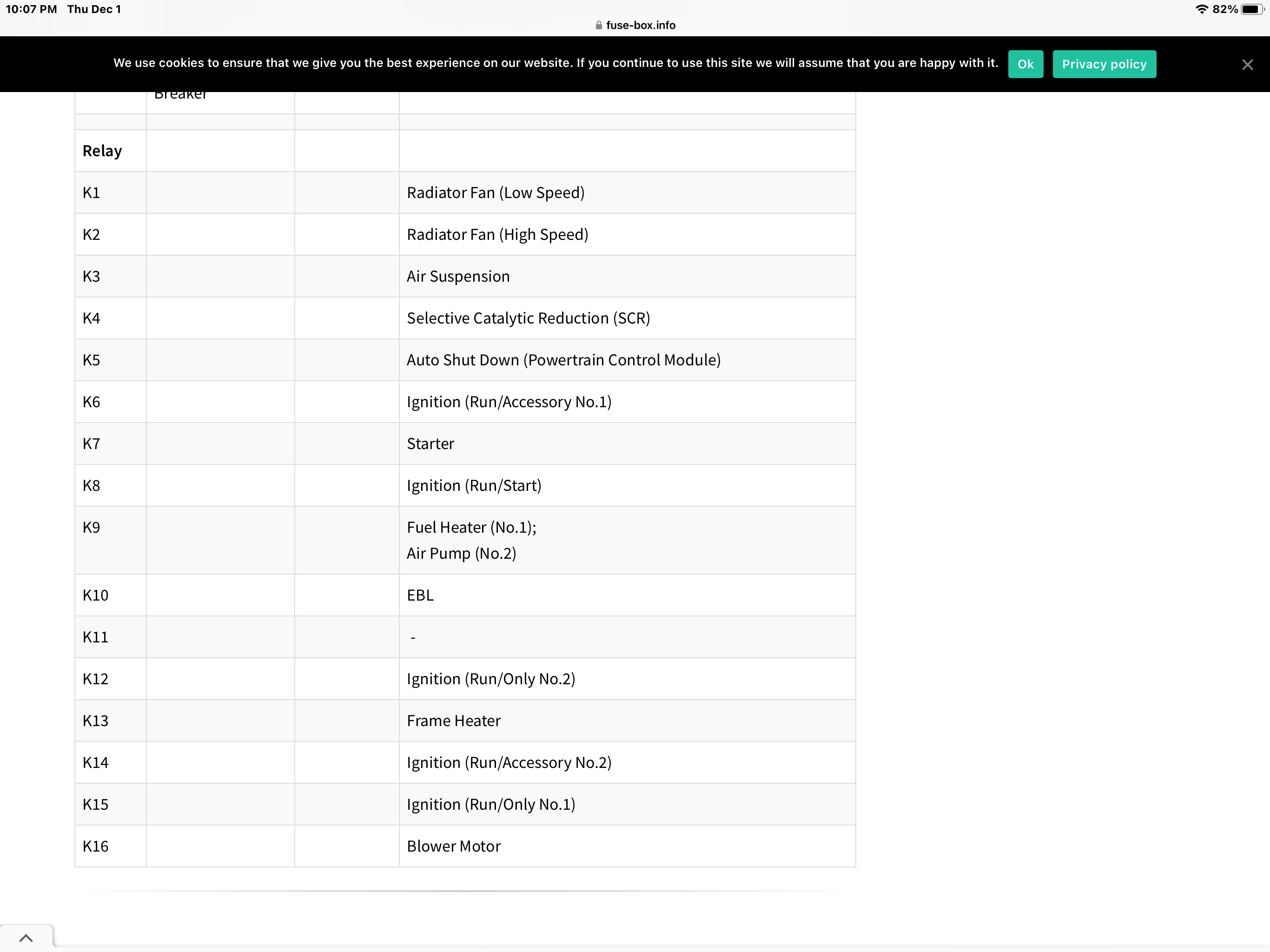

So, the A/C clutch relay has gone bad and sticks, I would replace it to fix the problem here is the location which is under the hood in the fuse panel on the right side of the engine compartment. Check out the images (bBelow). Please let us know what happens.

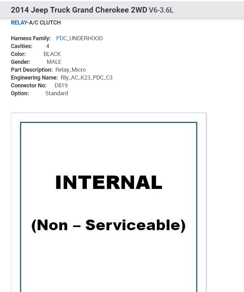

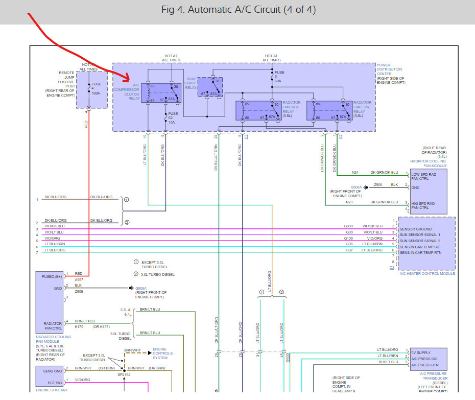

That was my first thought as well, however, there does not appear to be an A/C clutch relay or not one identified in the fuse box. Did not see a relay list in the fuse box as you described - I have had relays to stick and even weld together before and had original thought the same thing when I was troubleshooting but I could not locate - I believe that it controlled by the HVAC module, but I have not located and ac schematics to verify.
Dec 1, 2022 at 8:14 PM

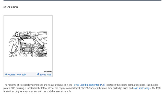

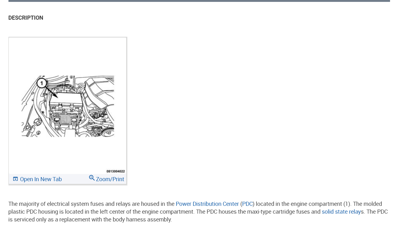

Okay, even though it shows it in the wiring diagrams the relay is internal to the PDC (power distribution center) and cannot be replaced. You might be able to disassemble it and unsolder it to install a new one, if not you will need to replace the PDC. Check out the images (below). Please let us know what happens.
Dec 2, 2022 at 11:29 AM
JAZZBAMA
Took it to the dealership and they replaced the PDC. I will updated if this does not solve the issue. Thanks for the help.
