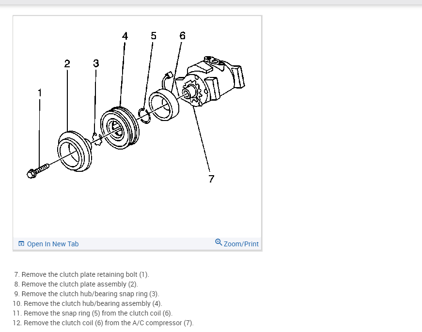

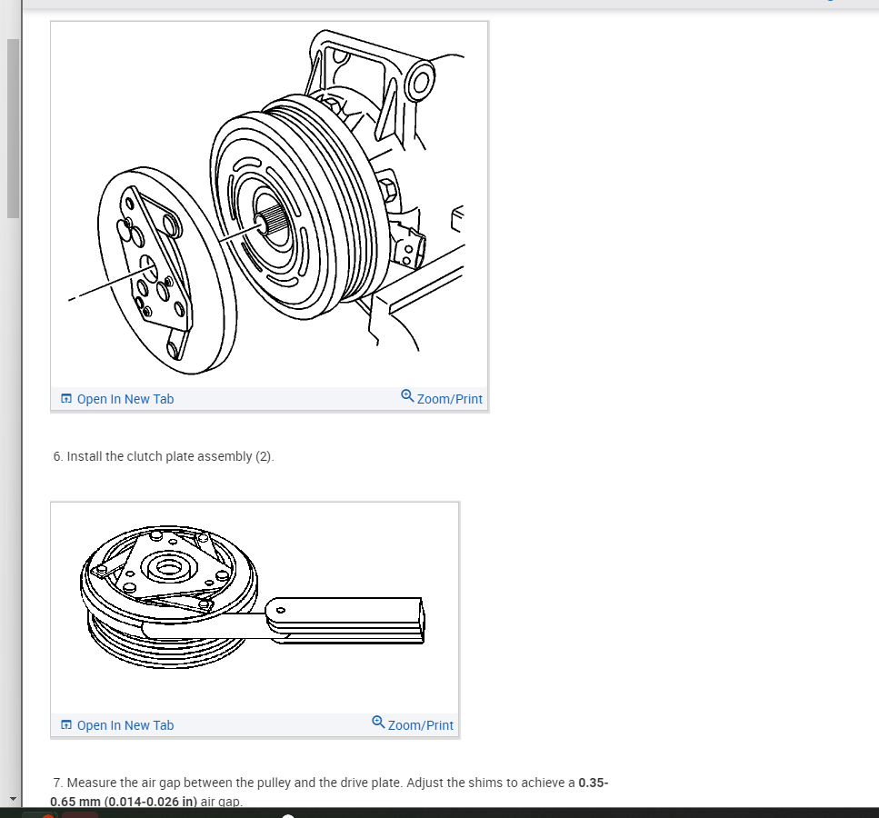

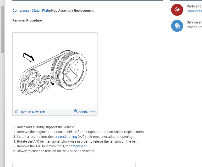

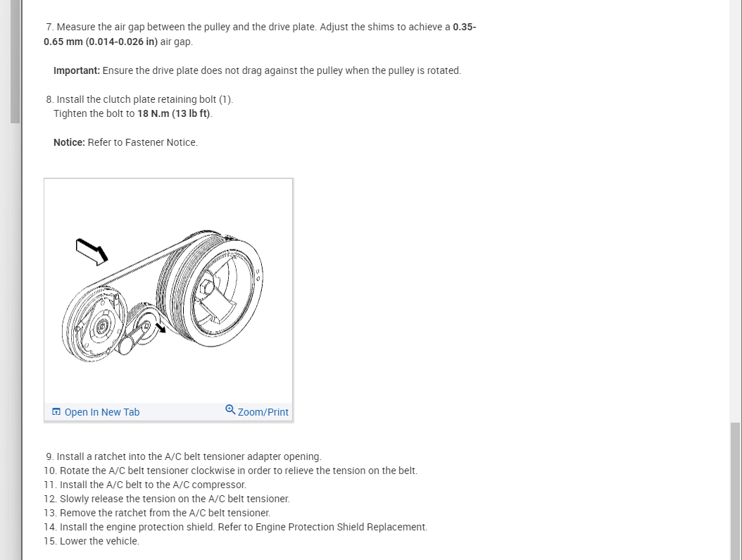

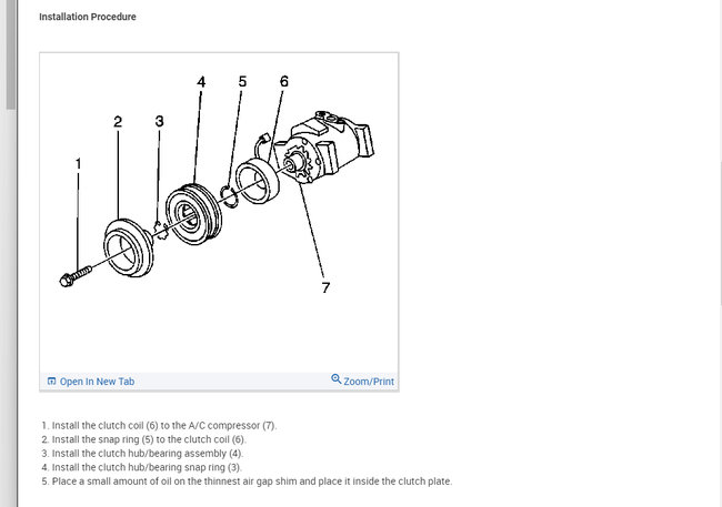

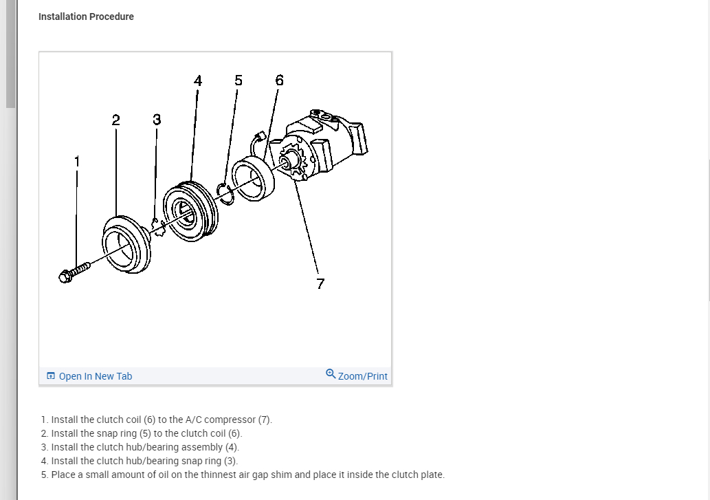

Based on all this info I would agree with you and be replacing the clutch and coil, so I am attaching this process below.
Thanks
