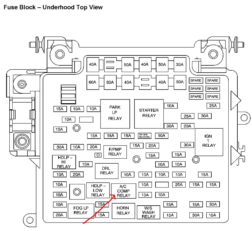

I have a 1.0-amp parasitic draw on my vehicle. I literally pulled every fuse and relay from the under-hood fuse box and the one in the driver's side of dash. It did not lose the 1.0-amp draw. I am super confused. Well, I put it all back together and now I have no A/C clutch engagement. I check all A/C fuses and have 14.4 v. I swapped the A/C clutch relay with knows hood relay and also have power at the 30 pin and the 85 pin so it's calling for A/C. I just don't have voltage at the clutch connector itself.

So, if the A/C clutch relay sticks on which is common it will cause the draw you speak of it will take out the compressor clutch coil as well. I would remove the clutch control relay and see if the draw goes away, and if so, disconnect the wiring from the compressor and with the system on check to see if the coil is getting power (Relay reinstalled). If so, replace the compressor or the compressor clutch coil.

Check out the images (below). Let us know what happens and please upload pictures or videos of the problem so we can see what's going on.
