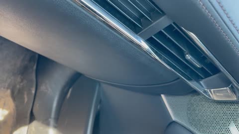

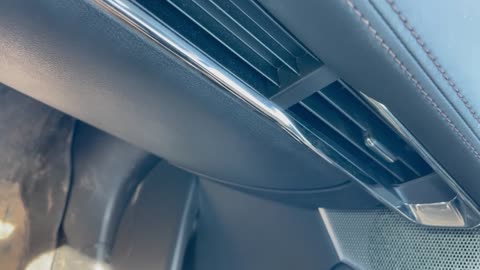

I have the vehicle listed above 3 that makes a faint intermittent "chh chh" like noise that the dealer hasn't been able to identify. The dealer cleaned the blower motor last time I brought it in, but the noise is still there. I've attached a video of the noise below (note that the noise I'm referring to is not the clicking of the air blend door at the very beginning of the video). Any thoughts as to what this noise might be would be greatly appreciated!!

As for the noise, it does sound like a rotational noise that is pretty consistent.
Does the noise get faster if you speed up the blower motor? The fact that they cleaned it would not repair it in my mind. It should more like a bearing noise which would create the chirping noise. It being dirty would not cause this type of noise so clearly, they returned it without confirming the noise was gone.

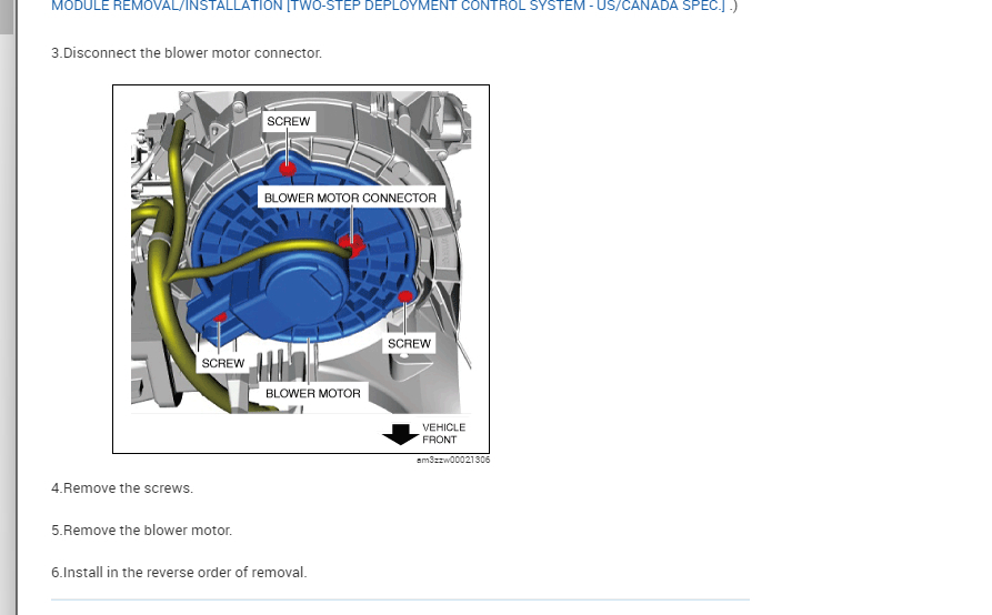

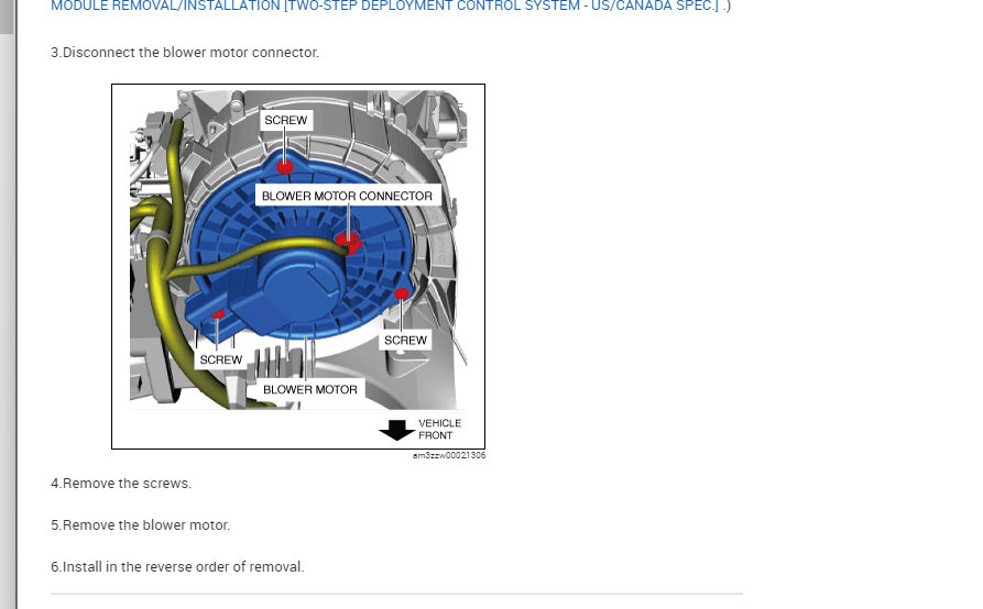

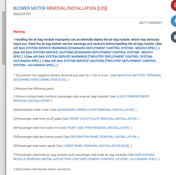

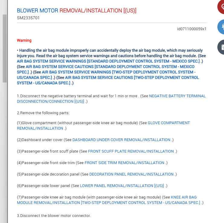

What I would do is if this noise seems to be related to the blower motor, then I would remove it and put it on the bench and test this.
Basically, you can just put 12 volts to the motor, and it will spin and that will tell you if it is the motor because you will hear it clear as day with it on the bench.

If they say it is normal and you want to address it, then that is where we will need to access the fan for closer inspection.
