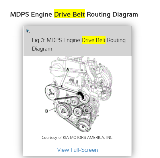

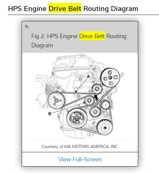

You can get a smaller belt that is made for the car that does not have a/c. You can bypass the a/c compressor.

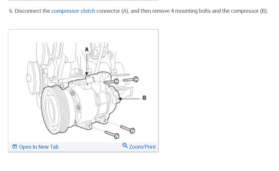

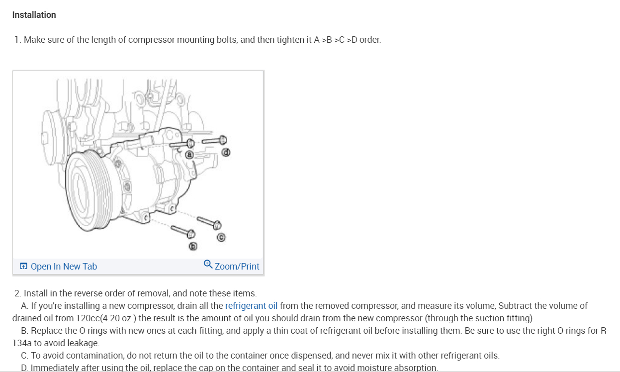

You can only put a shorter belt on there is it does not hit anything which it looks like it might. I have included a guide on how to change out the compressor which you can get on Amazon for about $140.00 with instructions on how to change it out on your car in the images below.
https://www.2carpros.com/articles/replace-air-conditioner-compressor
and for the recharge which you don't need to do right away.
https://youtu.be/4EqdrBVb0sY
Check out the images (below). Let us know what happens and please upload pictures or videos of the problem.
