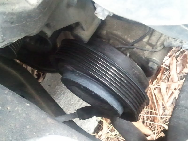

You can't just bypass the A/C on that car. There has to be something in the position of the compressor to route the belt around. It does not have a clear path between the remaining pulleys.

No, you pretty much summed it up. New compressor, new clutch or compressor eliminator pulley if they make one and apparently they don't for that one.

Yes you can but you're putting money into an already junk compressor.
Jul 29, 2019 at 1:37 PM (Merged)
SATURNTECH9
  • 30,869 POSTS
Sorry wrench tech didn't see you replied to this one when I posted a reply.But auto zone has just the clutch bearing for 15.If the clutch is still good and not locked up you could change the bearing.Auto zone even rents the tools for the clutch I believe.

PMF1220
To bypass the ac pulley on my car cuz the ac compressor pulley is messed up pulley is canted the side and the track for the belt is coming off and so is the pulley
