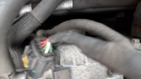

Hello. Thank you for your quick response. I have attached a video of the sound from the car. Also, do you know if this clutch is something that can be fixed without replacing the entire compressor? I spoke to a mechanic and he told me I am better off replacing the entire compressor because then if something happens to the compressor later on, I will be mad I spent the money on three compressor. But that should be my choice, not his. Right? I have bad luck with this mechanic already. I had my brakes done 2 weeks ago and I hear a rattle from the driver side rear wheel when I hit bumps & took it back 3 times but I still hear it. He also put perfect stop brake pads on it that are on eBay for $20.00, yet he charged me $70.00 for them. But I'm sorry, I'm getting into another question. One at a time. Thank you again for your time and quick response. I greatly appreciate it!!

Okay. Thanks for the video. That helped because if the engine was running the belt should be spinning and it looks like it is not moving. If that is the case, the crank shaft is spinning but the belt is locked due to the compressor not spinning. I suspect the compressor is completely locked up and the belt is seized to the compressor pulley. If that is the case then the compressor will need to be replaced. I would remove the belt and try to spin the compressor by hand with the engine off. If you can't spin it then the whole thing is locked up and requires replacement.

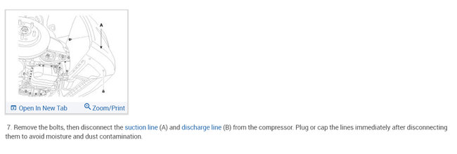

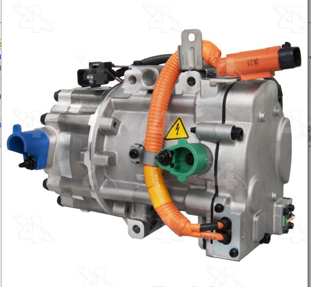

Thank you for that. I missed this was a hybrid and that explains everything. Yes, this would be the clutch that is making this noise. However, I don't show repair parts for the clutch. I only show the compressor assembly itself. So I am not sure why the mechanic told you that there was an option unless he knows something I don't. Here is a picture of the compressor.
This is electronically controlled and not part of the belt drive system. That means there is an electronic signal to the compressor to tell it to come on and off so this doesn't have the traditional clutch.
My suggestion would be to try to live with the noise if the compressor is operating. This being a hybrid, this compressor is pretty expensive.
Again, I am not sure why they told you that you may have an option with the clutch because I am not seeing that.

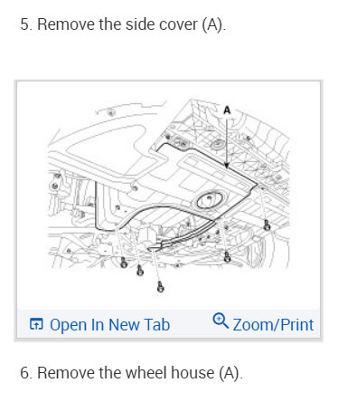

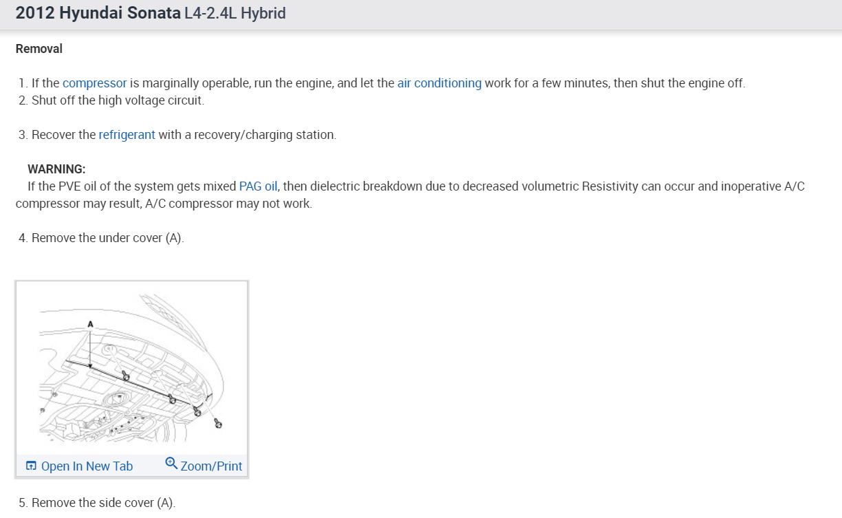

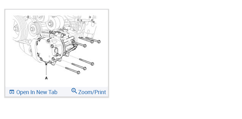

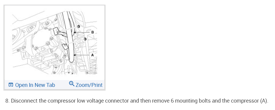

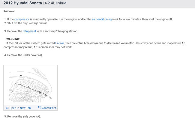

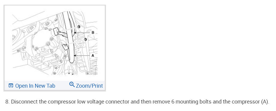

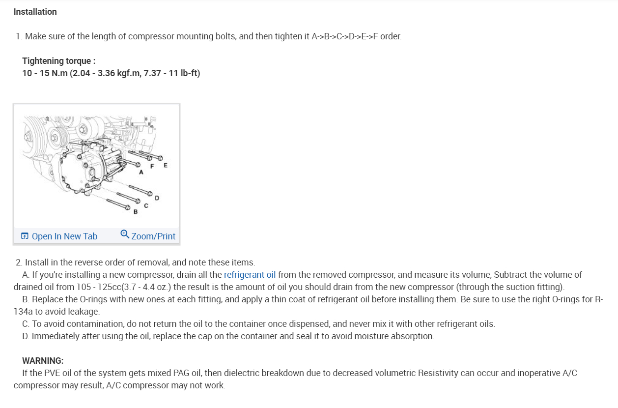

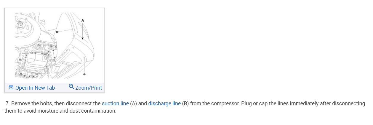

Here are instructions in the diagrams below to show you how to replace the compressor with a guide to help you recharge the system.
Check out the diagrams (Below). Please let us know what you find.
