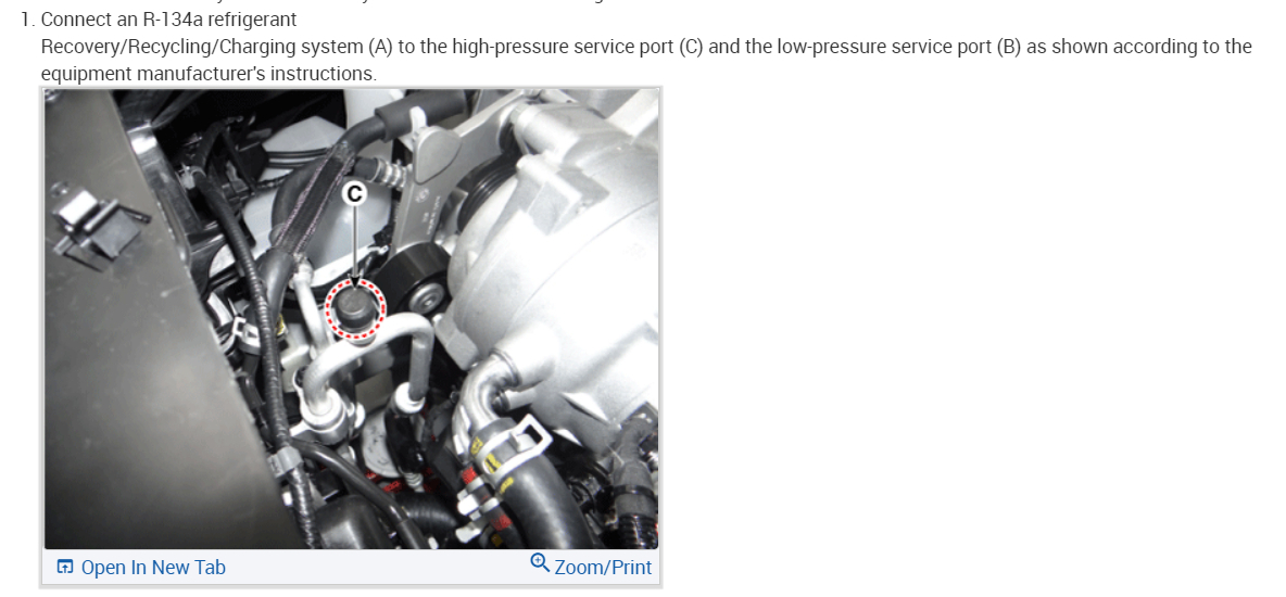

Hole in the compressor? That would be a first for me, but you never know. To be sure let's check the A/C pressures. You can rent an A.C gauge set for the auto parts store I believe. Please check out this video:
https://youtu.be/4EqdrBVb0sY?si=RbG_b2zt98JI_SX7
and
https://www.2carpros.com/articles/air-conditioner-leak-detection

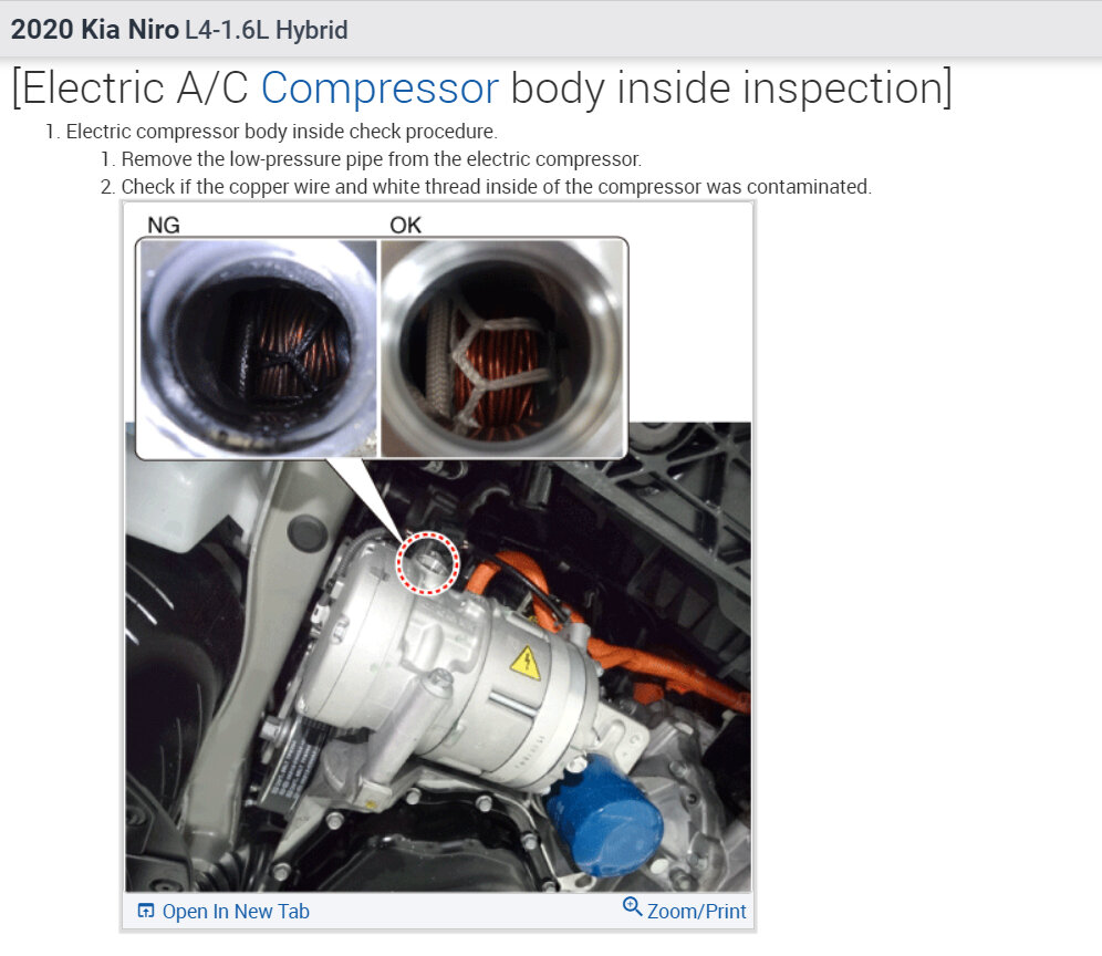

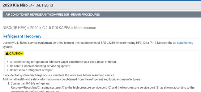

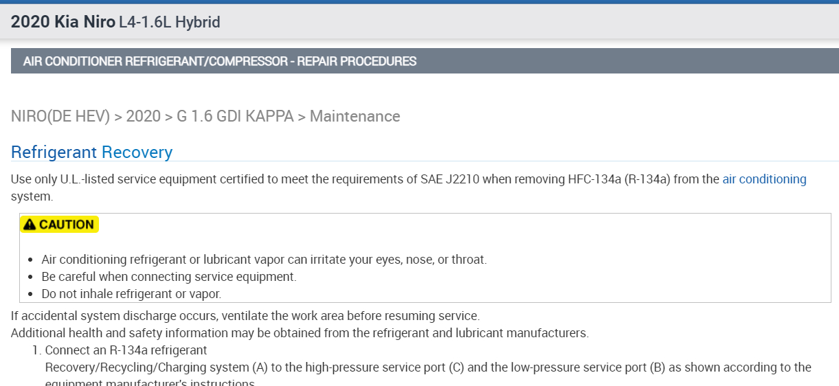

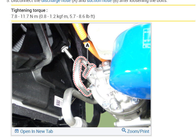

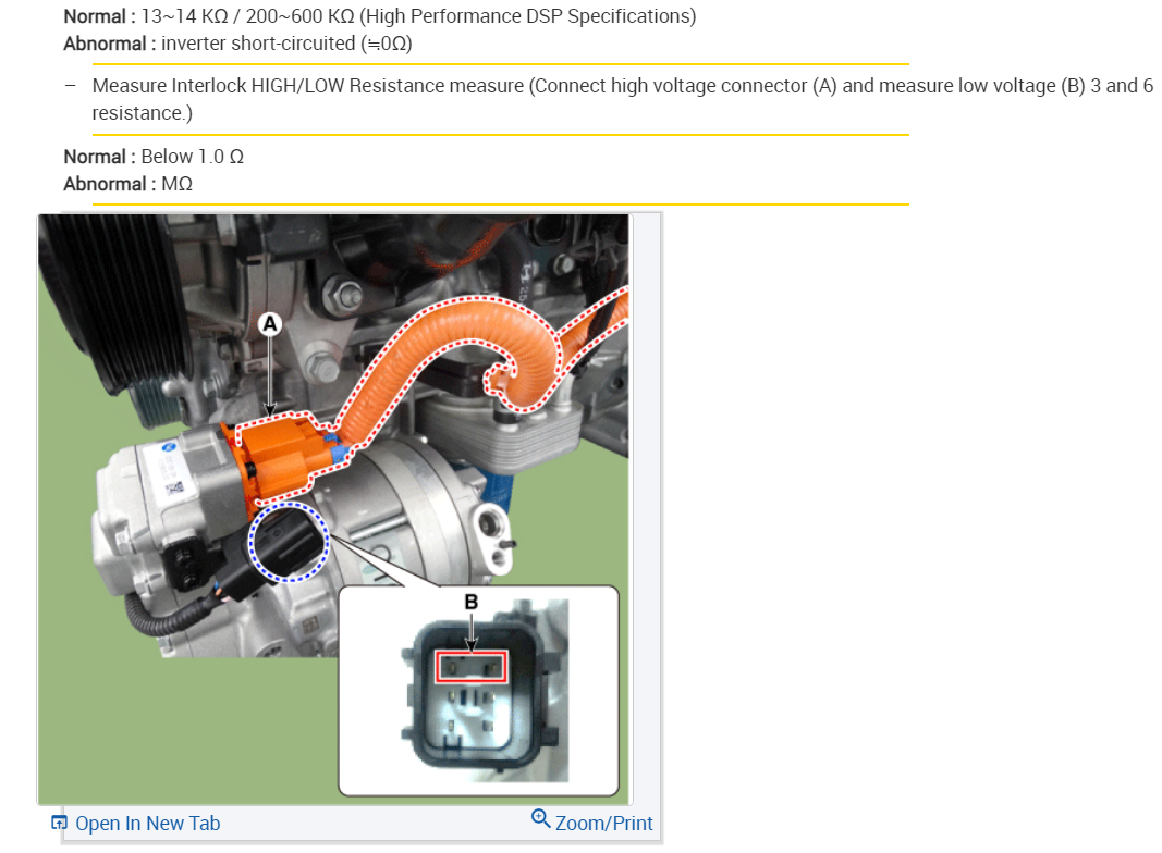

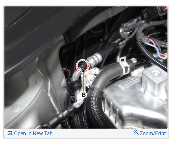

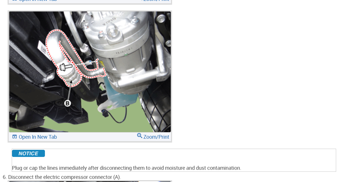

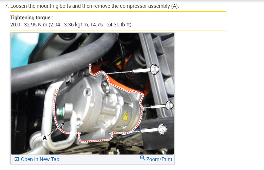

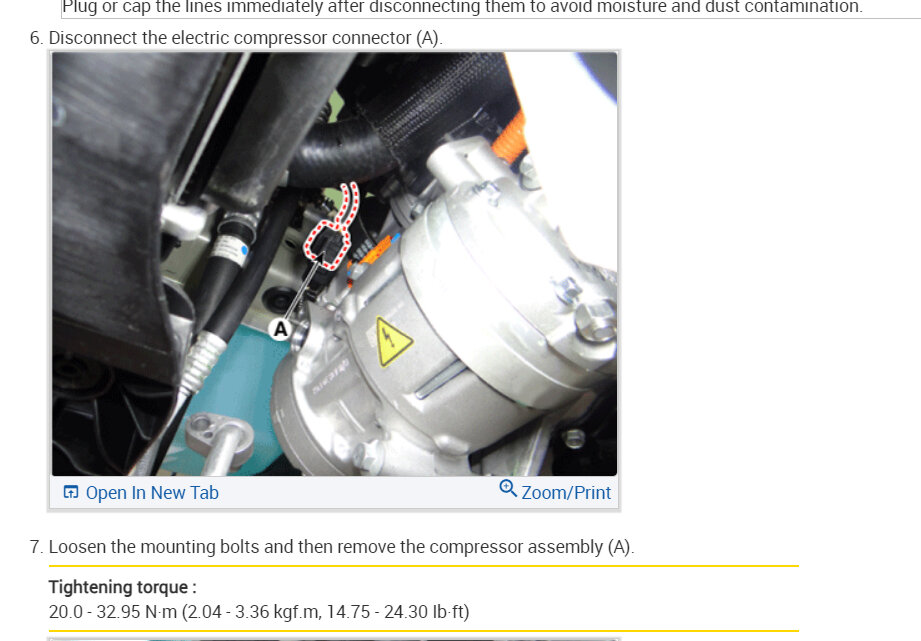

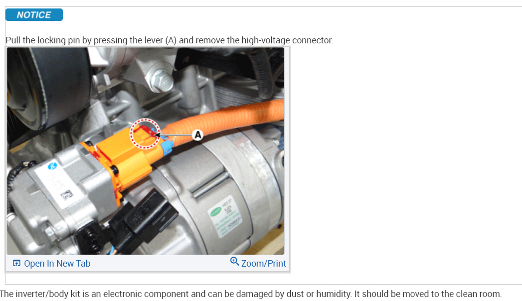

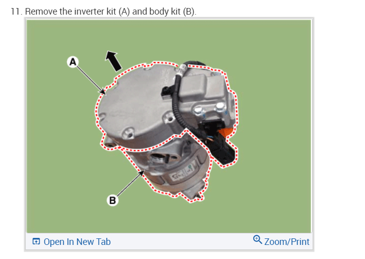

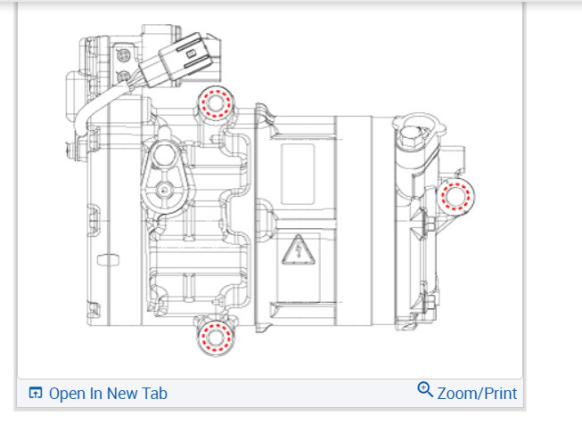

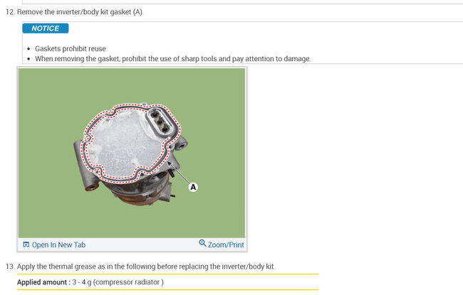

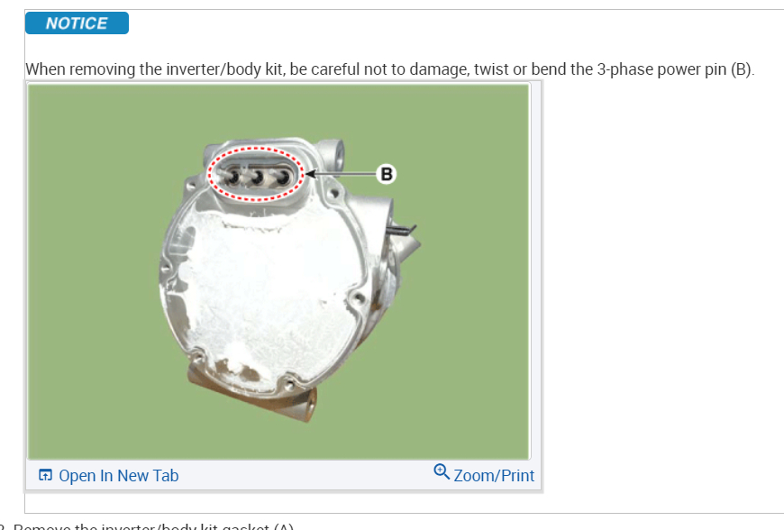

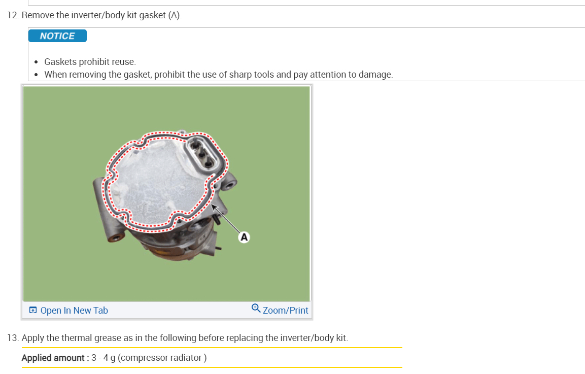

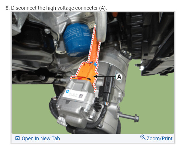

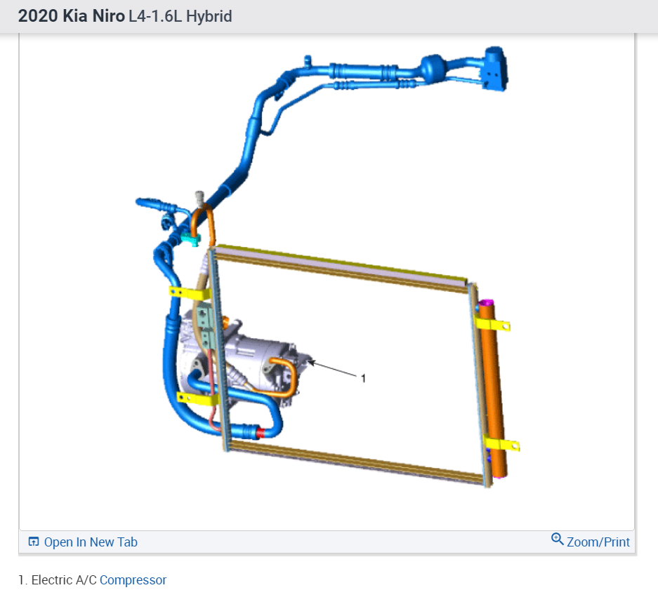

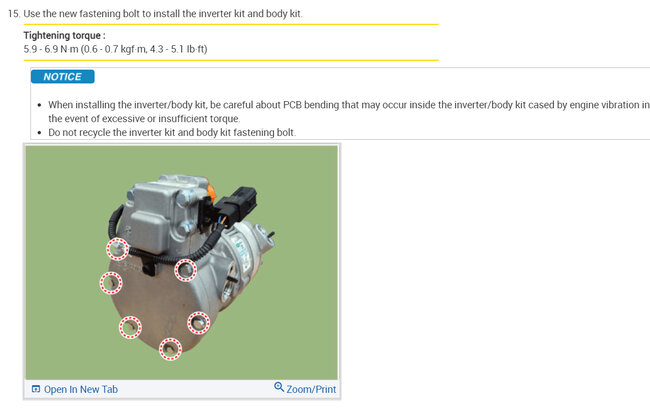

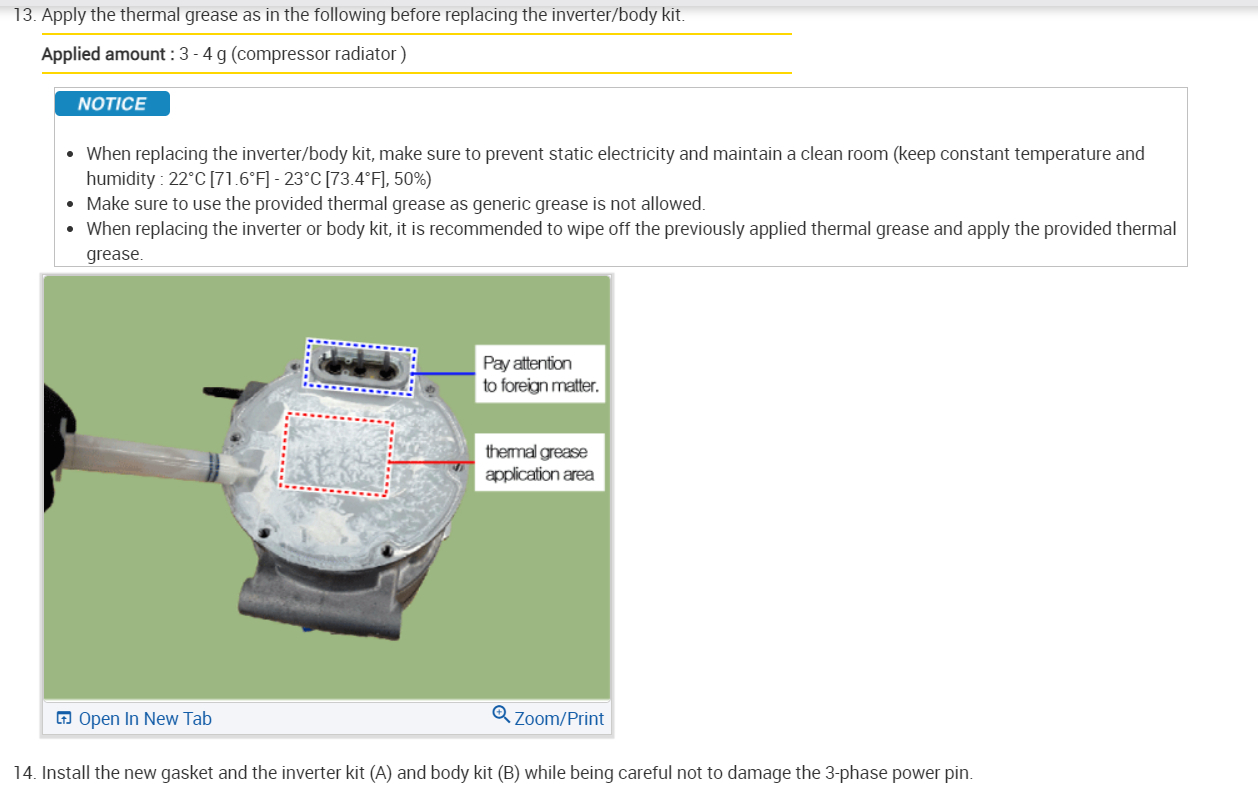

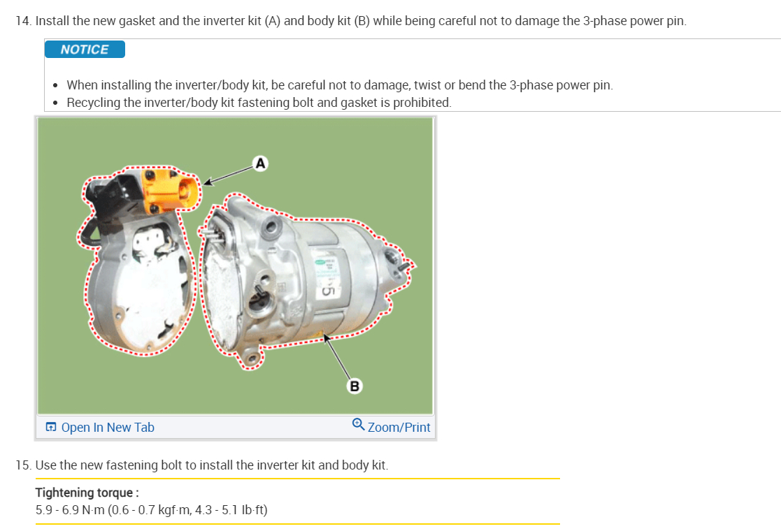

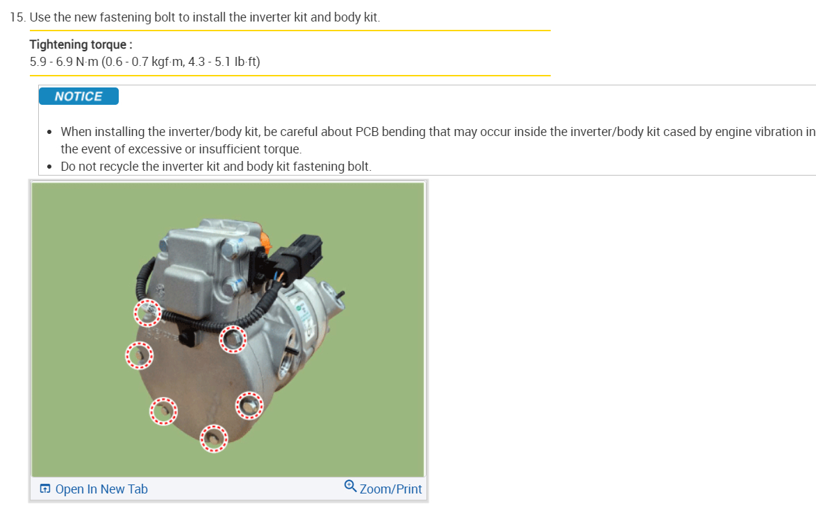

This car has an electric compressor so you will need to swap out the voltage inverter. Here are the instructions on how to do the job. Check out the images (below). Let us know what happens and please upload pictures or videos of the problem so we can see what's going on.
