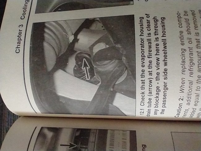

The mechanic did add dye and used UV light and detected dye/leak at base of condenser. And leak at firewall at evaporator drain tube. I know I need a condenser.
But I wonder if maybe the evaporator drain hose may be clogged? I don't see any wet carpet inside car. So maybe, the evaporator and heater core are okay? Because if evaporator is leaking, it is big job removing this. And I am not doing that!

The heater core won't effect the A/C as they are not connected but if there was dye found in the drain the evaporator core has a leak as there is no other way for the dye to get there. It won't cause a wet carpet as there isn't a lot of moisture unless it's a very humid day. The leak at the condenser means it would need replacement as well.
As for replacing the evaporator core, yes you need to pull the entire dash out then remove the HVAC case and then split the case to replace the core. The issue with A/C work is that even a tiny leak will drain the system in a short time so it may not be worth it to do any other repairs if you don't replace the evap core as it will just continue to leak. As much as I loathe them you might try a test, remove the lines to the condenser core and connect them, then run a vacuum test and see just how bad the evap leak is. If it's not real bad you might try some sealer. Then see if it holds pressure, if it did you could replace the condenser core and see if it holds up for a while. I dislike sealers as they cause a lot of problems with A/C machines, if you try one be sure to put a label on the system saying that it was used.
