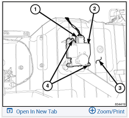

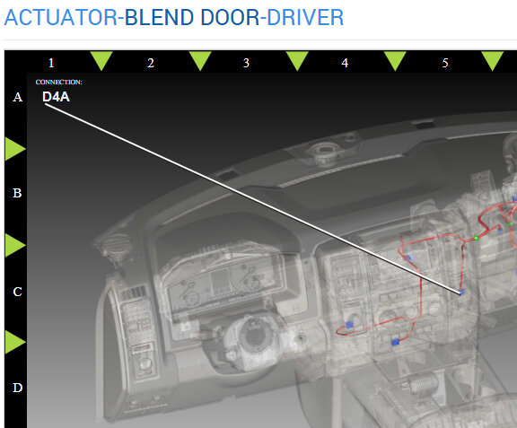

1. Driver Side Blend Door Actuator (Left Temp Door Actuator)
Location: Usually mounted on the driver side of the HVAC box, under the dash near the steering column.
Signs of failure: clicking noises, not responding to temp knob, or stuck in one position.
