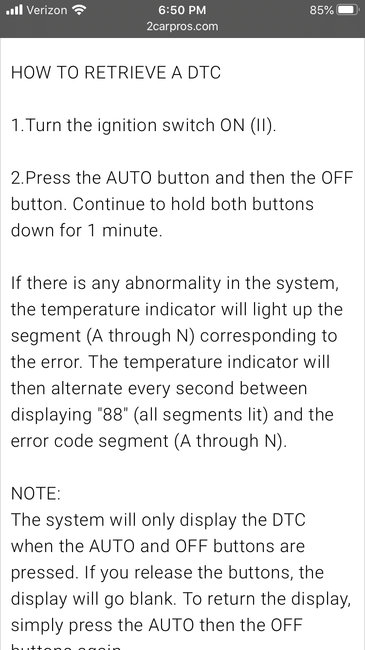

The AC in my son’s vehicle listed above Type S all of a sudden it started to blow hot air, I ran the DTC as per a previous question and it came up with the fail code of “k”. Can anyone tell me what that means please?

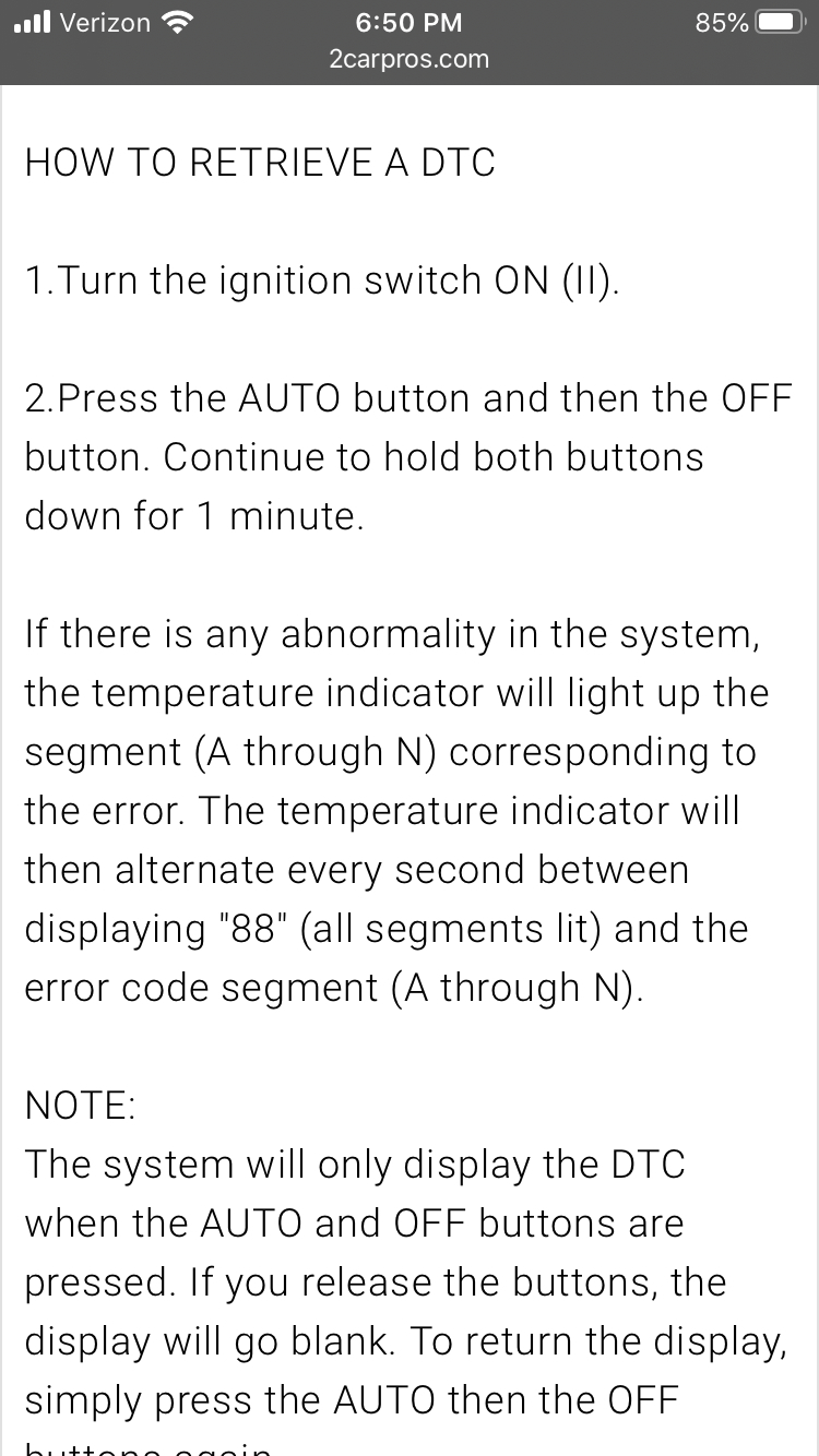

Good evening.. I used the instructions that an expert “KHLOW 2008“ on this site had placed to obtain the code. The compressor does engage and stays on.

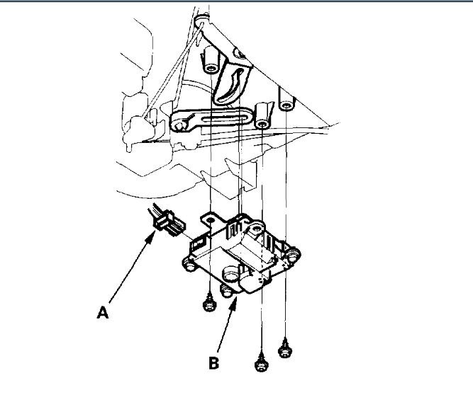

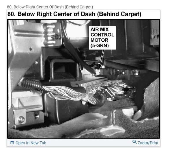

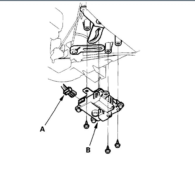

I attached the picture and location of the air mix door.
DTC indicator light K: A Problem in the Air Mix Control Linkage, Door, or Motor
1. Test the air mix control motor.
Is the air mix control motor OK?
YES - Substitute a known-good climate control unit, and recheck. If the symptom/indication goes away, replace the original climate control unit.
NO - Go to step 2.
2. Remove the air mix control motor.
3. Check the air mix control linkage and door for smooth movement.
Do the air mix control linkage and door move smoothly?
YES - Replace the air mix control motor.
NO - Repair the air mix control linkage or door.
