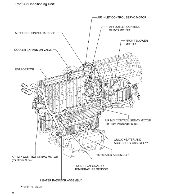

Welcome to 2CarPros. That description sounds like a bad air mix door actuator for the drivers side. The door actuator on the case is on the drivers side. However replacement isn't an easy thing as the entire dash has to come out to access the part. Below is the process.

75. Remove air conditioning unit
76. Remove front air mix control servo motor sub-assembly
Reverse these to reassemble the system.
What I would do first is look up above the gas pedal and see if you can see or reach that actuator before doing the above. If you can it might be possible to move the actuator enough to control the temperature without removing it for now.
