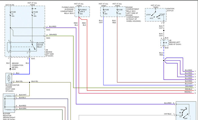

I've read several comments about fan only working on 1 speed, but mine does not work at all. Is this the resistor or the control. I cannot find a control for my car. I guess it could be a bad blower as well.
Any ideas?
Any ideas?
