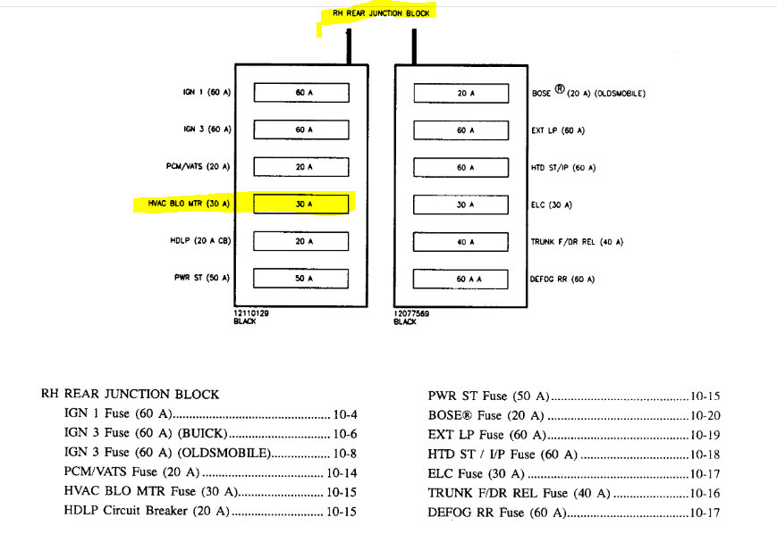

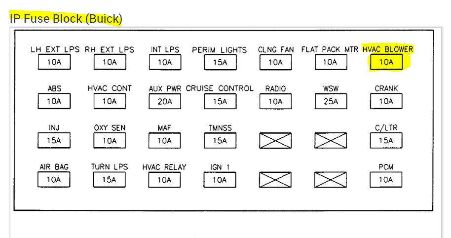

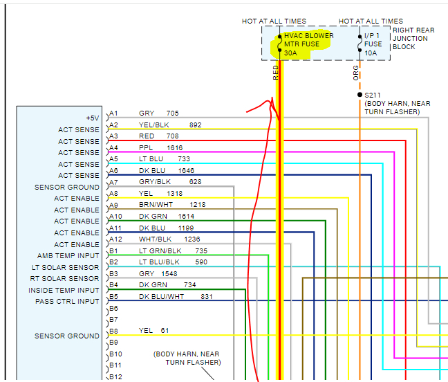

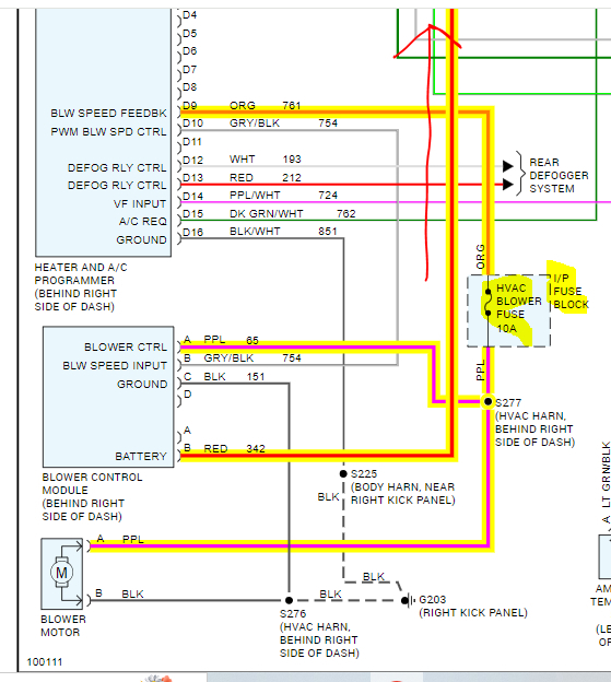

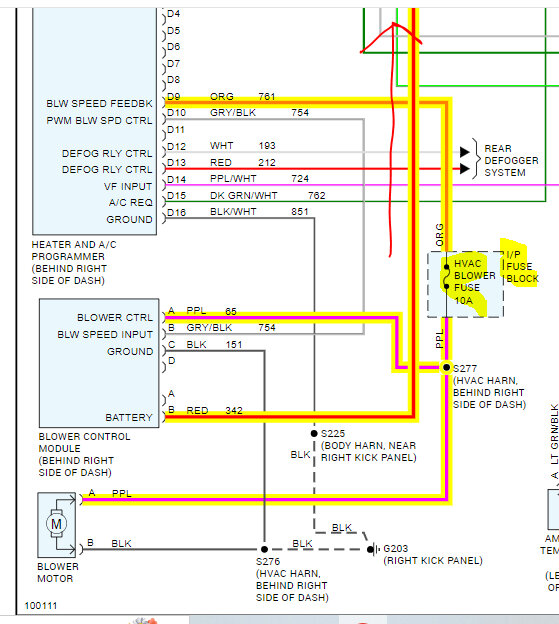

I attached two pics below showing from the wiring schematic. Note there are two fuses. Here is the interesting part. Power to the blower motor comes directly to the motor from fuse from the right rear junction block. However, for that to power the blower motor, the blower control module has to provide a ground path.
Note that the ground is determined by the controller.
Before you removing any fuses, see if the wiring connector at the resister is damaged in any way. For example, see if a connector pin is bent and contacting a different pin.
If that checks good, then when it is running with the key off, remove the 10 amp HVAC blower fuse in the instrument panel fuse box. If that shuts it off, we have a short between the controller and control module (resister). If that doesn't shut it down, remove the 30 amp blower motor fuse in the right rear junction block. If that doesn't shut it, then we have a short to power from a different circuit.
