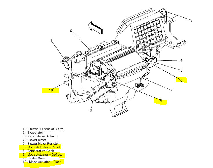

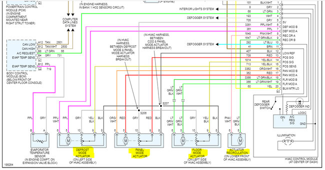

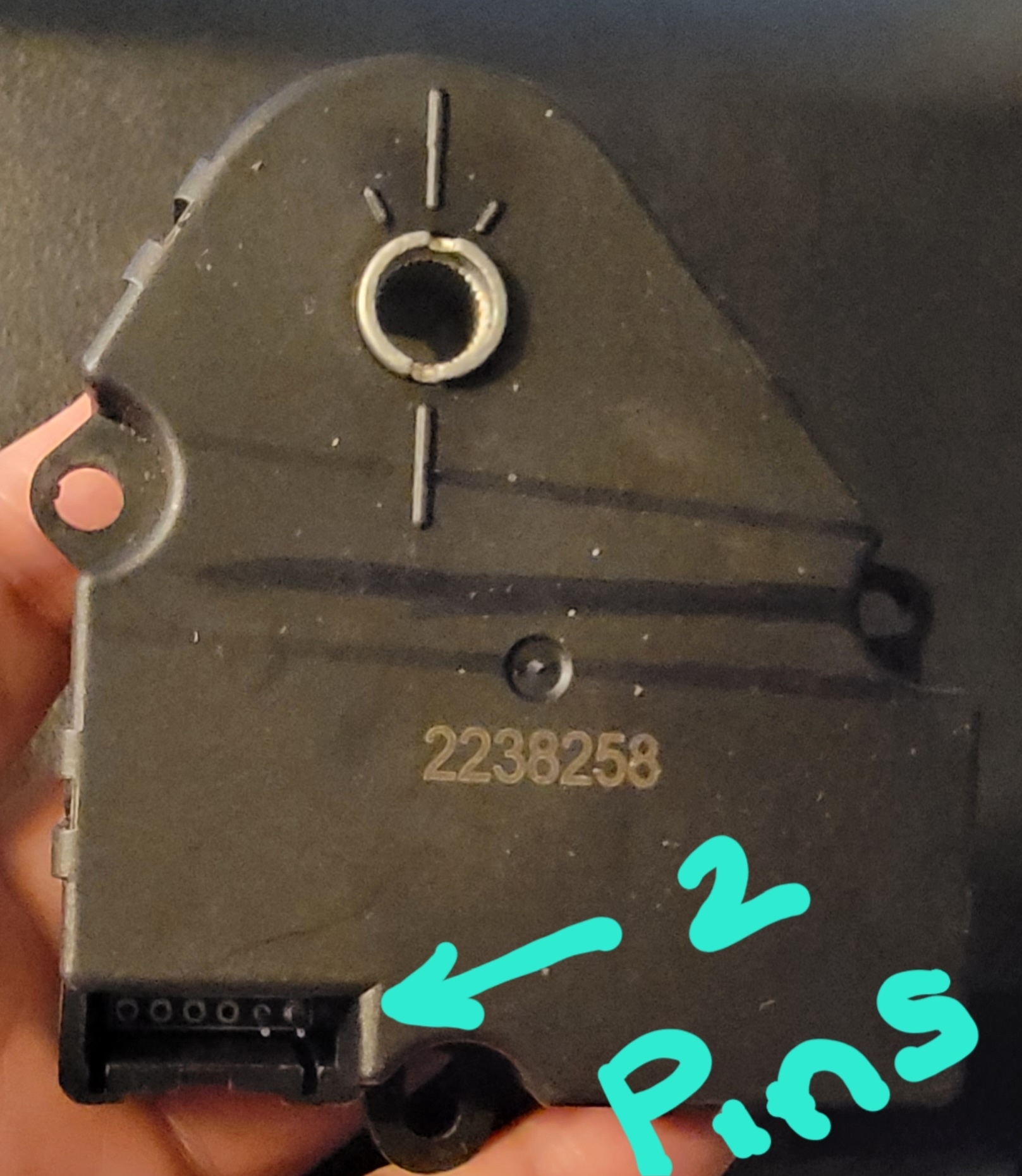

Initially, my A/C problems began with a winding-type noise, and it appeared to originate from front fans under hood. If I switched off the A/C, the noise would stop. This noise didn't always come on with ac running. Btw, the cooling fans are new now. Soon thereafter, my cooling/heating/defrost selection lights flickered on and off simultaneously until the light remained in defrost mode. Now, while attempting to select/Set to cold and recirculate, my control module remains in defrost mode. Plenty of air comes through vents. Also, I'm unable to select where air comes through, floor, rear defrost, etc. I'm sure it's not the blend door on the left side under the glove box. I bought a blend door 2233258 with 2 pins but I am not sure that the one high up behind the glove box is the issue but it's hard to get to it. Money is tight so I'm doing this on my own. Thanks.
