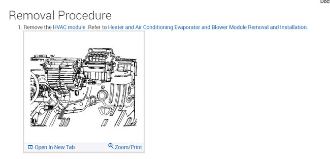

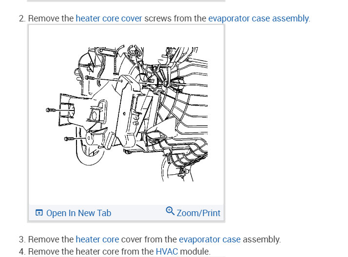

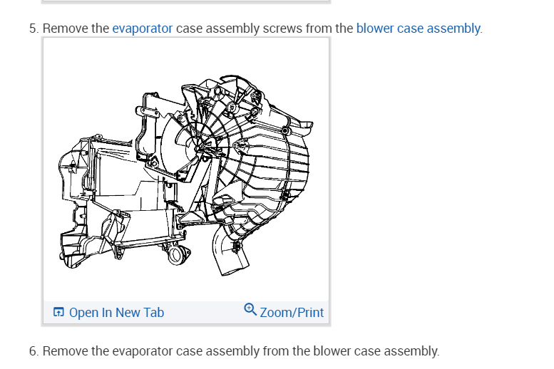

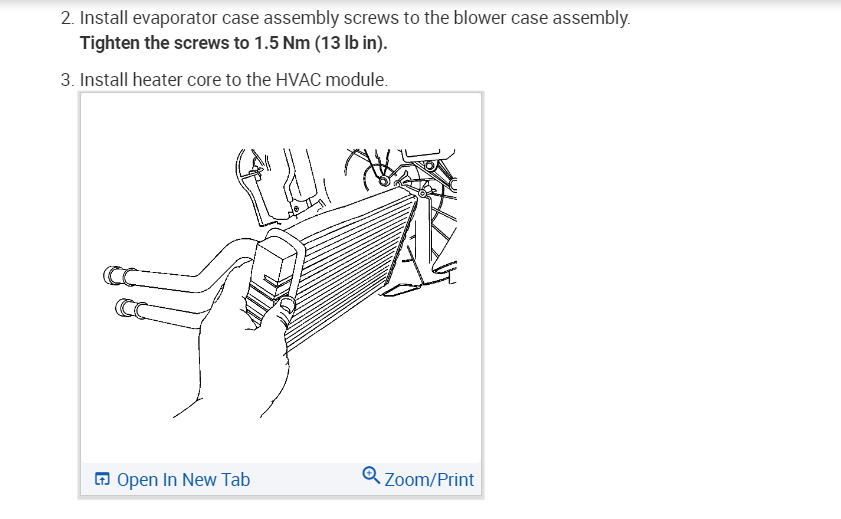

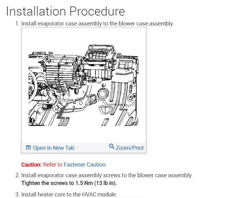

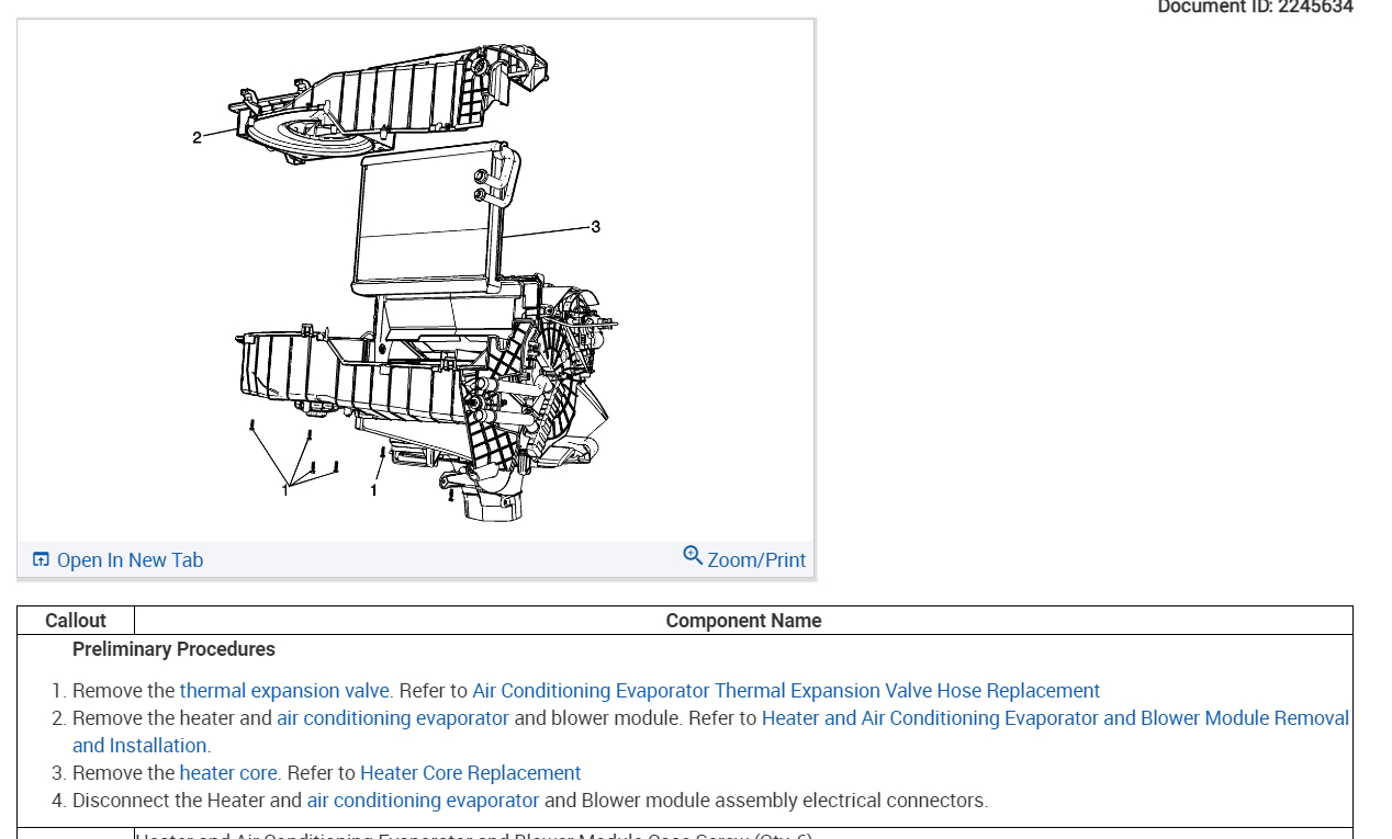

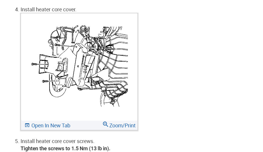

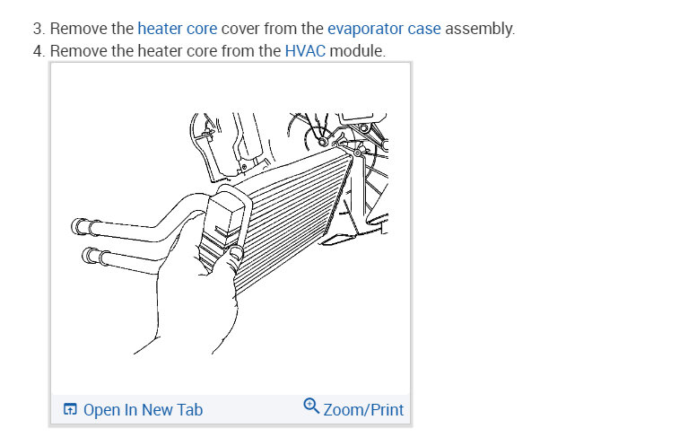

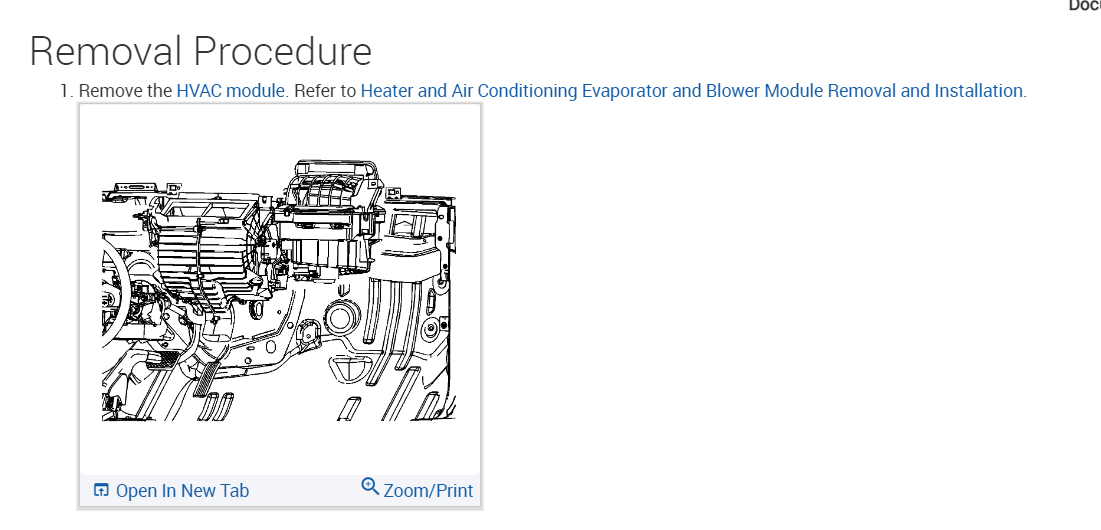

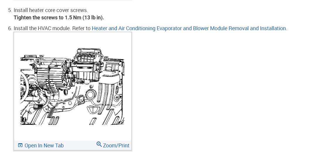

Yep, that is exactly what happens, the blend door must move freely. I would take it back and tell the repair shop they have a problem. Here are the images for the unit so you can get an idea of the repair. Check out the images (below). Please let us know what you find. We are interested to see what it is.

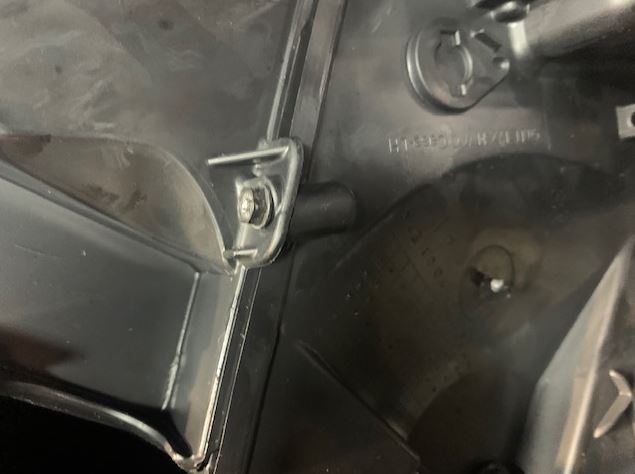

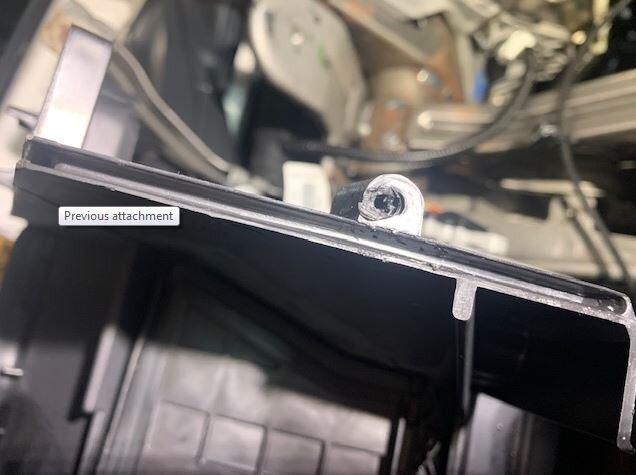

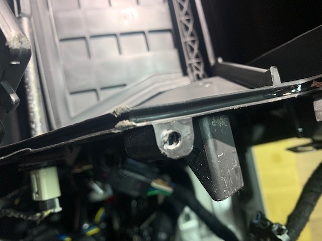

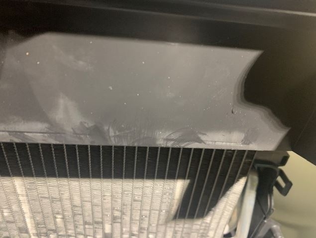

Thank you, gentlemen! Having worked at the GM Tech Center in Warren, MI as a technical illustrator for 13 years, creating the exploded views of what you see in todays "Repair Manuals," I knew exactly where the "Blend Door" was, and to be told by the people at Ice Cold Air that the problem was there before I brought it in, did not set with me. I removed the Blend Door actuator, that worked perfectly fine, so I knew the blend door was "stuck" after the dash was installed after the AC evaporator was installed. I ended up getting my full "labor" charge back and an apology for the bad work. From the photos you'll see how the screws were not aligned for reinstall, where the blend door was stuck and rubbing. Just a bad job overall but because of my background, luckily, refunded!

Yep, that will do it, it looks like the housing was not aligned correctly causing the malfunction. Good find, some mechanics need to slow down to do the job correctly or they make more problems. Thanks for getting back to us and for the images. Use 2CarPros anytime, we are here to help. Please tell a friend.
