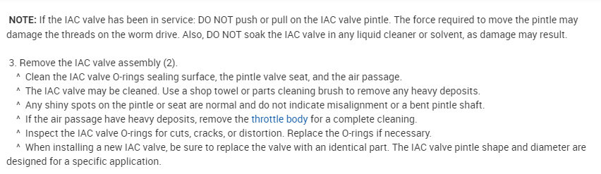

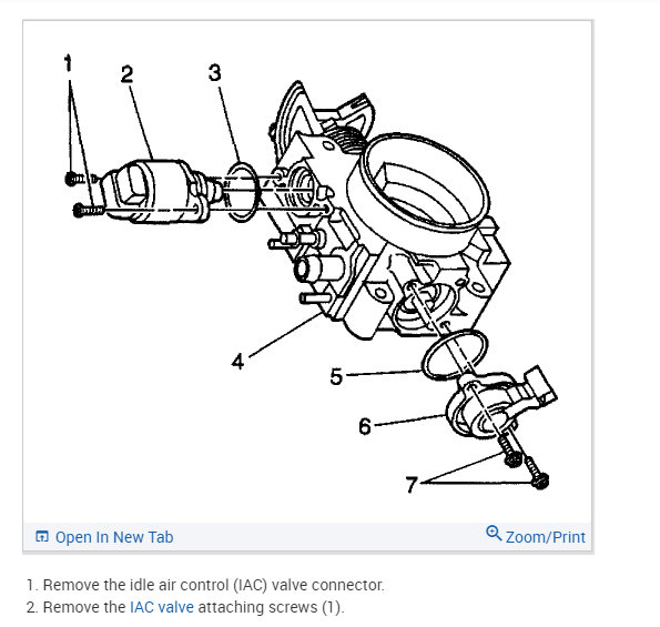

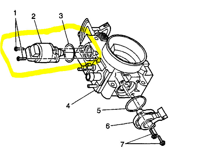

If you look at pic 1 below, I circled the IAC. Again, it is on the throttle body. However, before replacing it, first, check the connectors. Make sure they are clean, not damaged or corroded, and have a tight connection. If that appears good, then remove it. It's held in by two screws. There is an o-ring where it mounts, so be careful not to damage it.
Inspect the pintel on the IAC for corrosion. If it is clean, check where it attaches to the throttle body and make sure there isn't carbon or any dirt in the TB. At this point, I would try servicing it. Here is a link that explains how it's done:

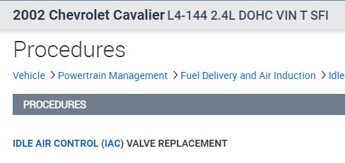

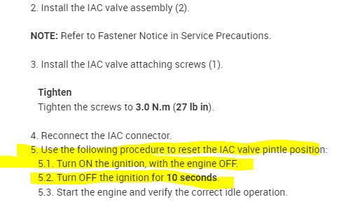

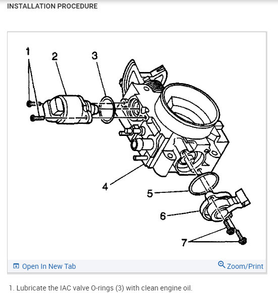

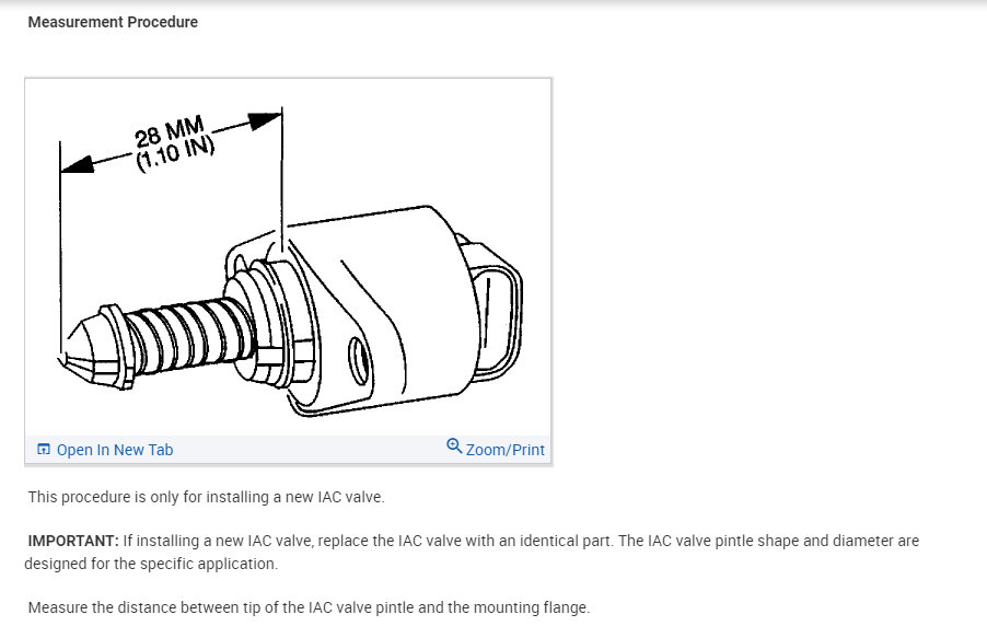

If you look at the remaining pics below, they provide the directions specific to your vehicle for replacement.
See pics below.
