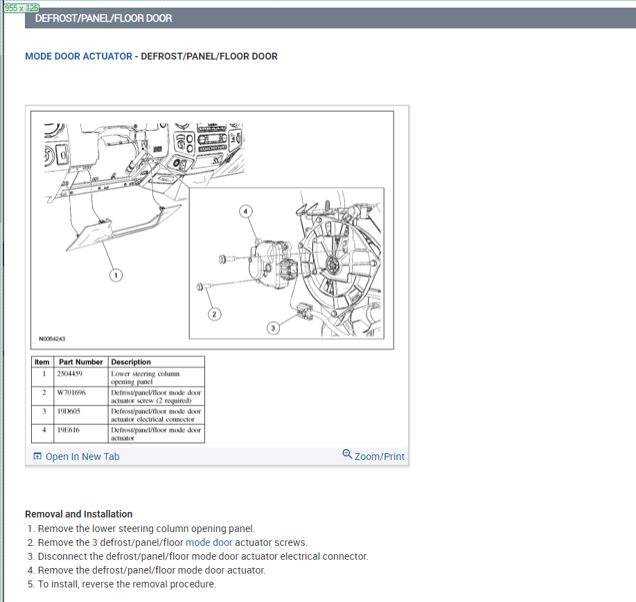

This is almost always the mode door actuator. Basically this is just the actuator that changes the position that the air is coming out.
Here is a guide on this that will help with step by step instructions:
https://www.2carpros.com/articles/air-vents-stay-in-the-defrost-position
Below is the info from the manual that will give the additional detail to change this out.
Please let us know how you make out. Thanks
