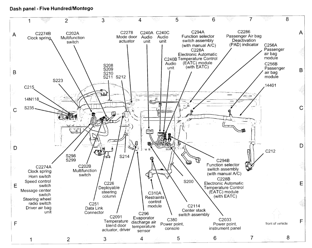

The only thing I can think of it the vibration of the engine must make the mode blend door actuator work. Let check the temperature blend door actuator. Here is a guide that will give you steps the change and check the door operation and the location of the actuator for your car below:
This will make the knock noise as well, put your hand on it to see if it is making the noise before you remove it. Check out the diagrams (below). Please let us know what you find.
