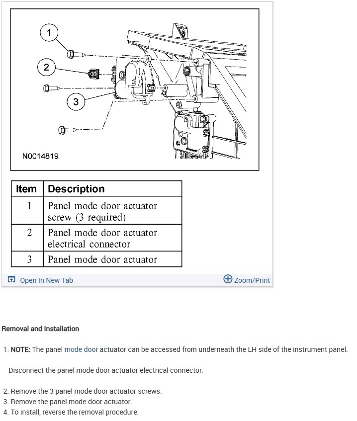

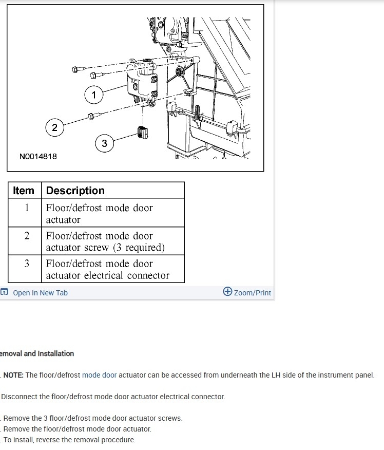

Which one? There is one that selects floor or defrost, that one is on the left side of the HVAC case just above the footwell, the actuator that selects the front panel vents is just above it the attached are the locations and r&r process.
