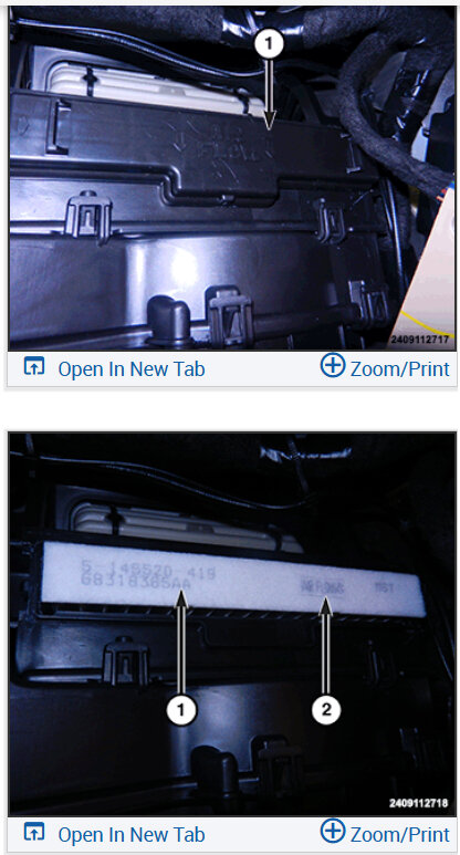

I would replace the cabin air filter first which is behind the glove box which I have included images below for. I have also seen the evaporator core ice up and stop blowing, if when you park the truck and you see a large puddle of water under it on the passenger side that can be happening. Please go over this guide to see what I am talking about.
https://www.2carpros.com/articles/why-your-cars-ac-evaporator-ices-up-and-how-to-fix-it
Check out the images (below). Please upload pictures or videos in your response.

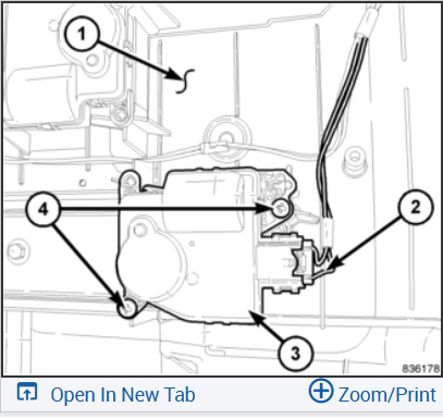

The mode actuator would be the only thing I can think of that can cause this problem. Here is the location in case you want to swap it out, also you should do a CAN scan to see if any codes are present that could help us as well.
https://youtu.be/u-4syLc-ifQ
Jul 19, 2025 at 9:29 AM
