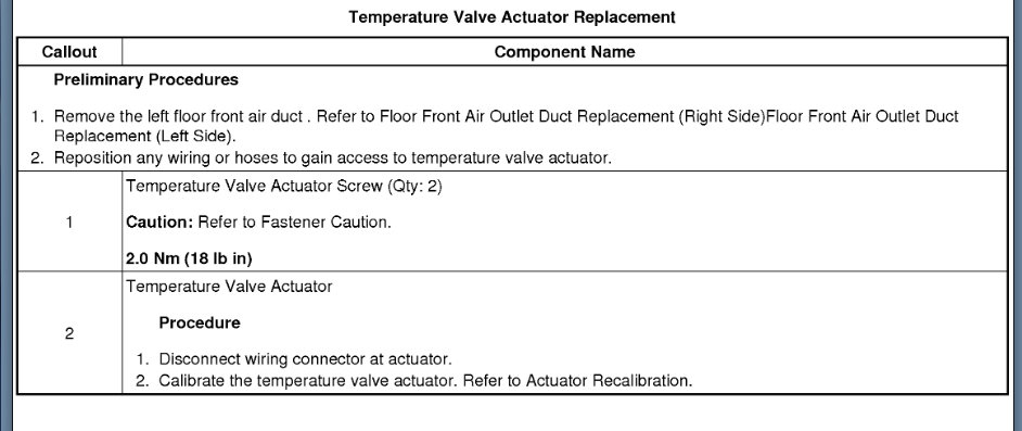

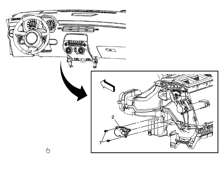

Okay. That means we need to start eliminating things that this could be because I am not sure of just one thing that could cause this. The most probable cause is the blend door actuator. We need to remove this and adjust the temperature and see if the actuator moves when it is plugged in but removed from the housing.
I attached the process to do this. Let me now if you have questions. Thanks
