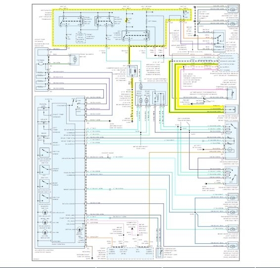

My van has Freon but the compressor clutch is not kicking in. any ideas?

Good afternoon,
Do you have gauges to give me the high and low side readings?
https://www.2carpros.com/articles/car-air-conditioner-not-working-or-is-weak

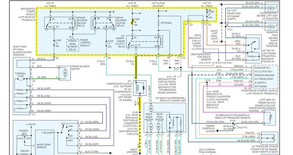

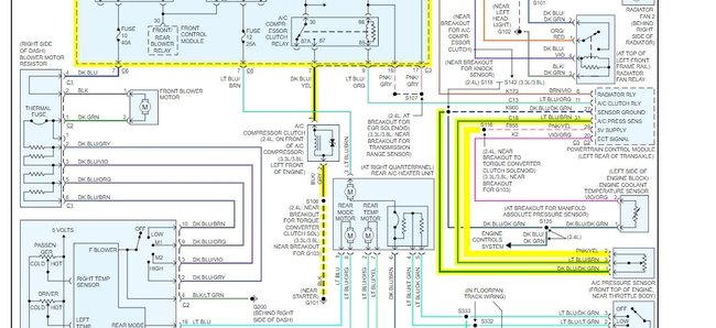

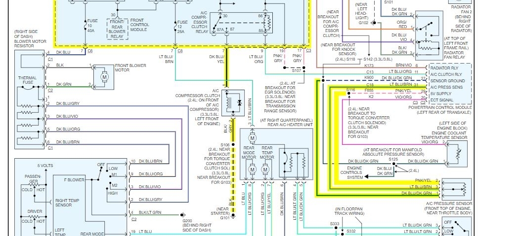

Have you checked all the fuses?
the compressor is controlled by the TIPM or the fuse block based on information from the pressure sensor. Check the fuse listed in the diagram for power on both sides.
