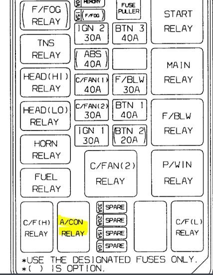

The reason it blew was because it couldn't cycle on and off with direct power. It built too much pressure. As far as no power from the supply, have you checked the relay? It is in the under hood relay box. See attached picture.
Here is a link explaining how to test a relay:
Aug 19, 2019 at 7:03 PM
Thank you very much. It was the relay. Thank yoh for your help!
