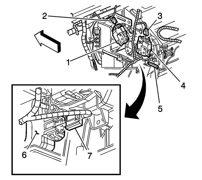

pic 1
1. Remove the driver side knee bolster.
2. Locate the air temperature actuator (6).
3. Disconnect the air temperature actuator electrical connector (7).

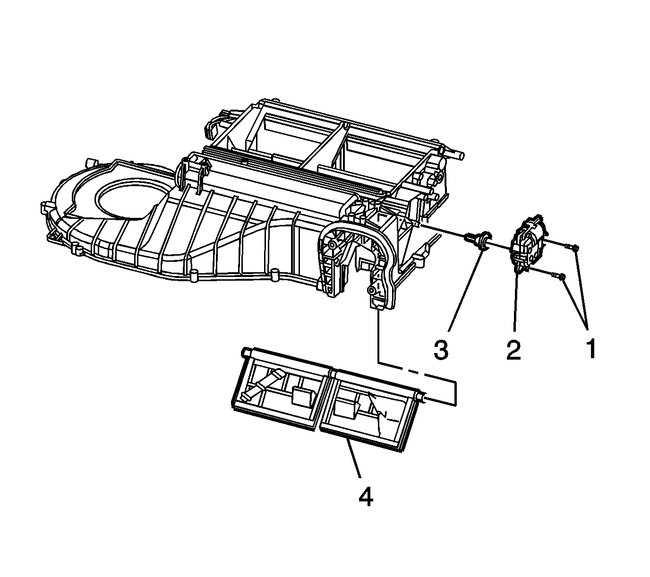

pic 2
4. Remove the air temperature actuator bolts/screws (1).
5. Remove the air temperature actuator (2).
6. Remove the air temperature actuator lever (3), if necessary.

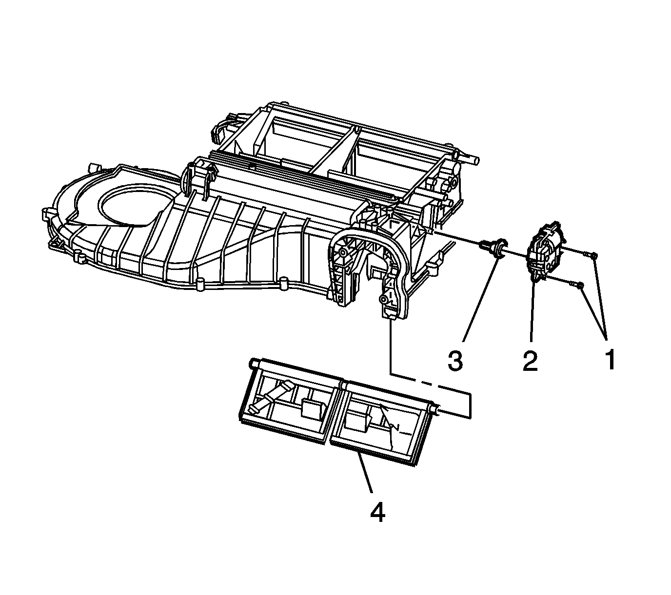

pic 3
Important: The actuator lever can only be inserted into the door one way.
1. Install the air temperature actuator lever (3), if necessary.
2. Install the air temperature actuator (2).
Notice: Refer to Fastener Notice.
3. Install the air temperature actuator bolts/screws (1).
Tighten the bolts/screws to 1.2 N.m (11 lb in).

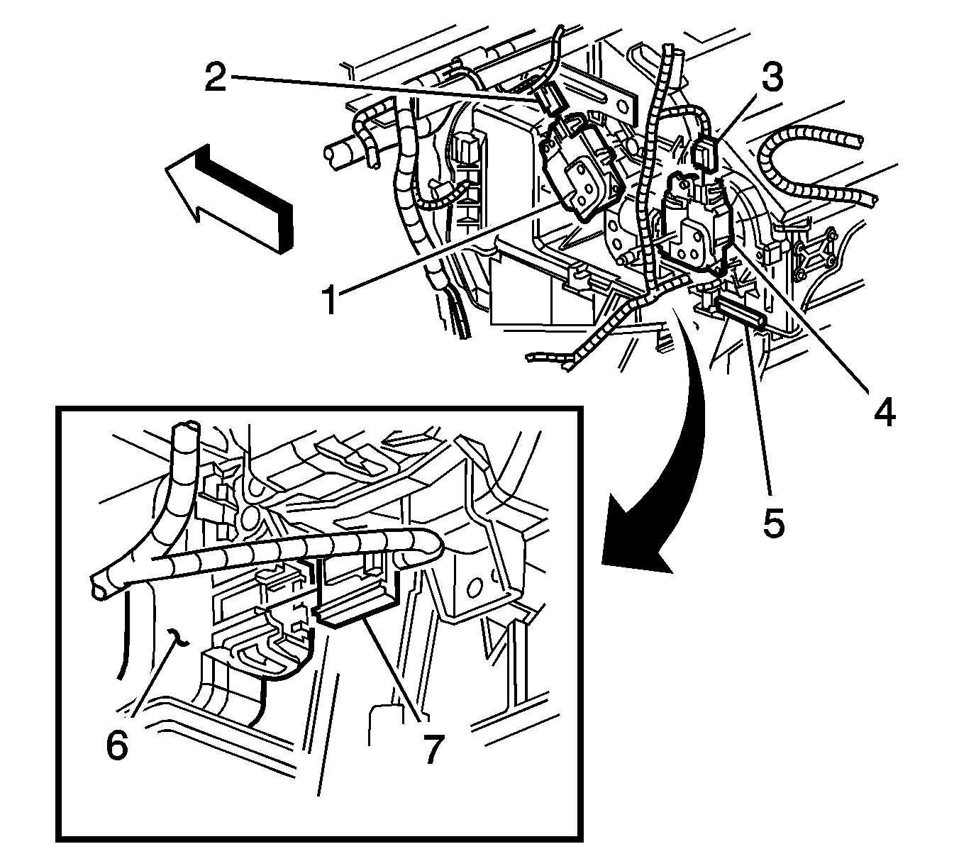

pic 4
4. Connect the air temperature actuator electrical connector (7).
5. Install the driver side knee bolster.
6. Re-calibrate the actuators. Refer to Actuators Recalibration. See: Vehicle > Programming and Relearning
