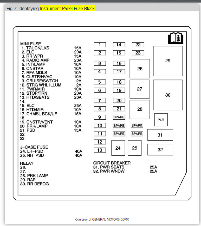

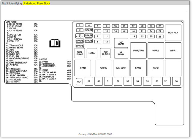

Rear air blower does not work. All fuses good.
Jul 27, 2017 at 10:12 AM

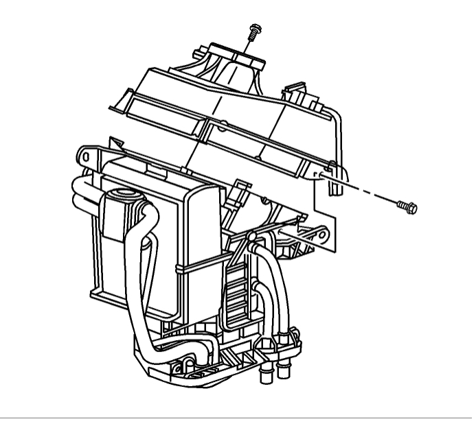

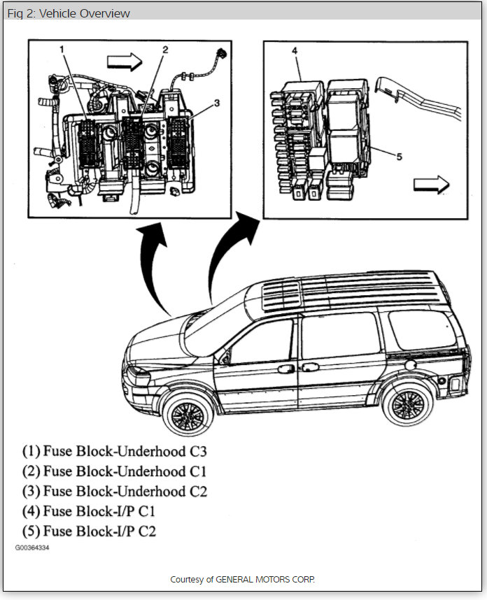

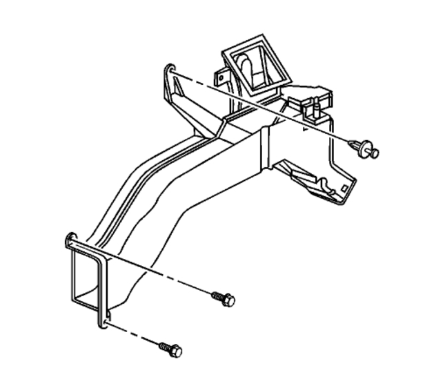

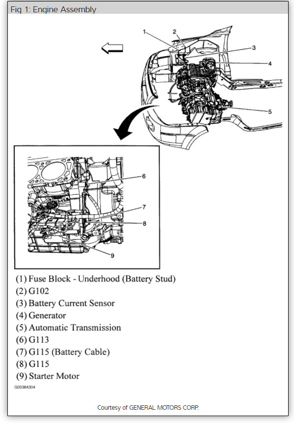

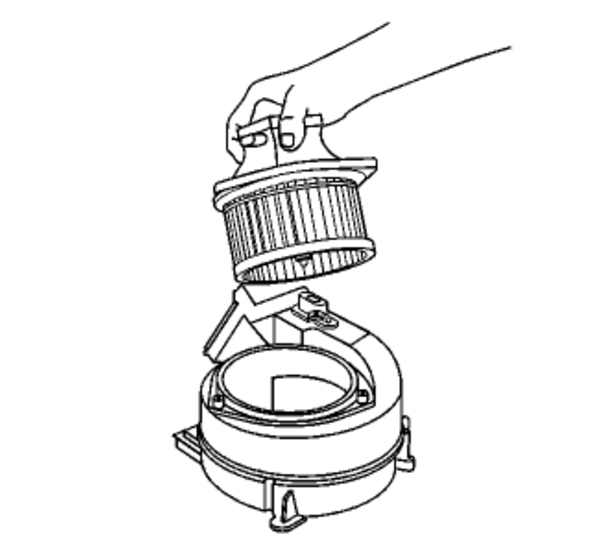

It sounds like the rear blower motor or relay has gone out. Here are some guides and diagrams so you can do some simple tests and get the problem fixed.
and
and
https://www.2carpros.com/articles/blower-fan-motor-works-on-high-speed-only
Here are some guides to show you where the blower and relay is (below)
Please run some tests and get back to us we are interested to see what it is.

I changed the front blower, but it still wont turn on. is there anything else I can do?

You can start where you should have started before buying a blower motor. That is to test for both power and ground arriving at the motor to determine where to go next.

It could be any number of things like fuses, motor, switch, resister, wiring or relay. The first step is to access the motor and test for power and ground arriving at the motor to determine which one, if any is missing and that will determine what direction to go from there.

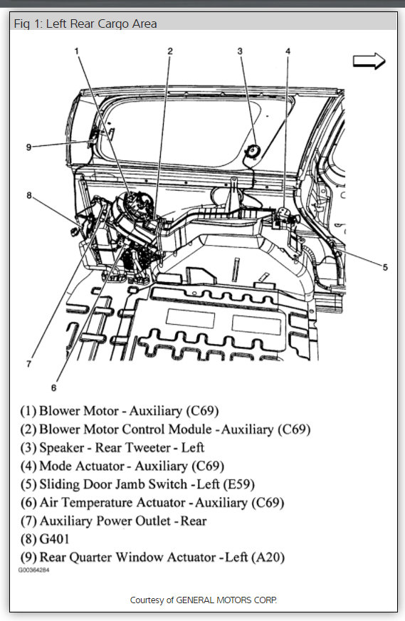

Where is the rear blower motor located on a 2005 buick terraza and how do you access it. I've looked online but can't find any diagrams or videos. I know where the front blower motor is but not the rear.
Jul 28, 2017 at 4:17 PM (Merged)
WRENCHTECH
  • 20,761 POSTS
It's behind the trim panel on the left side of the rear luggage area. https://www.2carpros.com/images/external/120463485.gif
