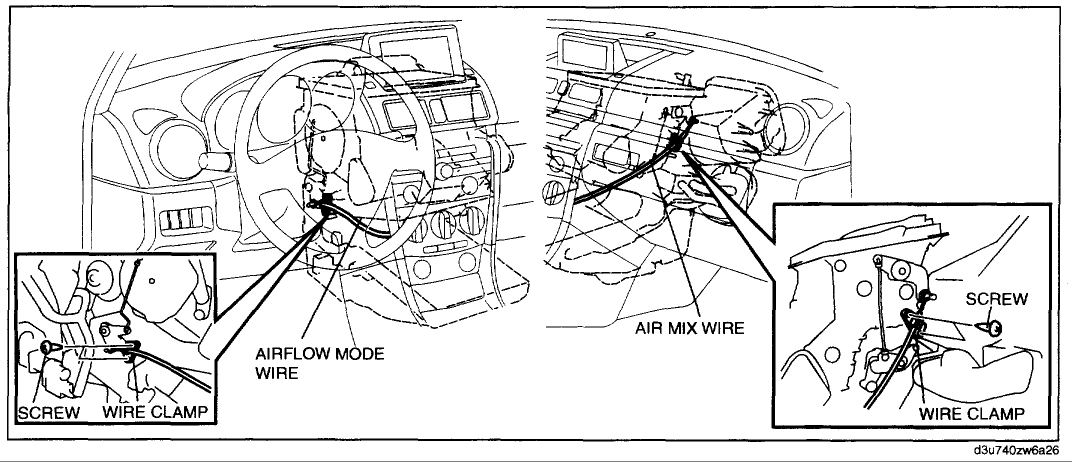

My thinking is that it is the air mix controls. It is what directs air through the heater or AC cores depending on the temperature desired. But they differ a lot in which type of system you have and are not fun to repair in either case.
