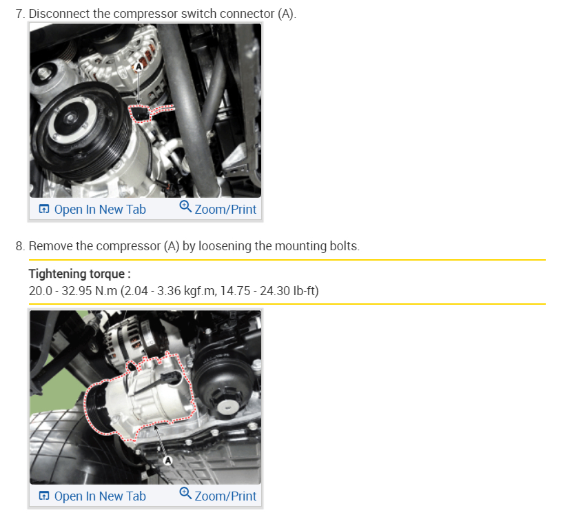

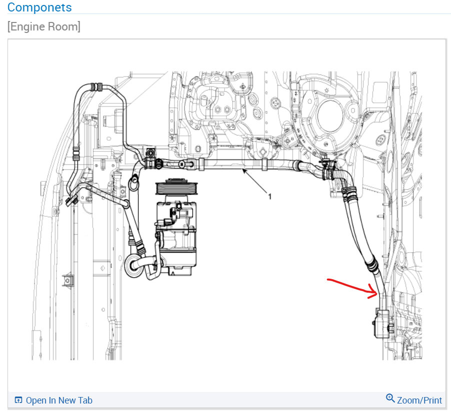

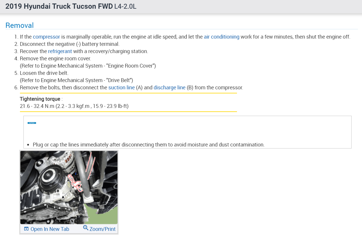

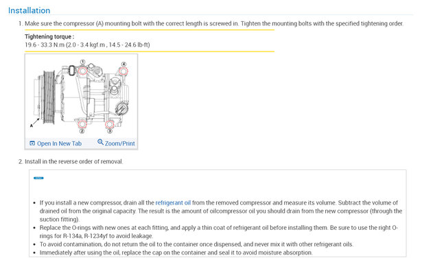

Also, you can grasp the outlet tube, which is the larger of the two-line coming from the firewall which can help us determine if the problem is from the HVAC control or actuators. Here is how to change out the compressor in case you need it. Check out the images (below). Let us know what happens and please upload pictures or videos of the problem so we can see what's going on.
