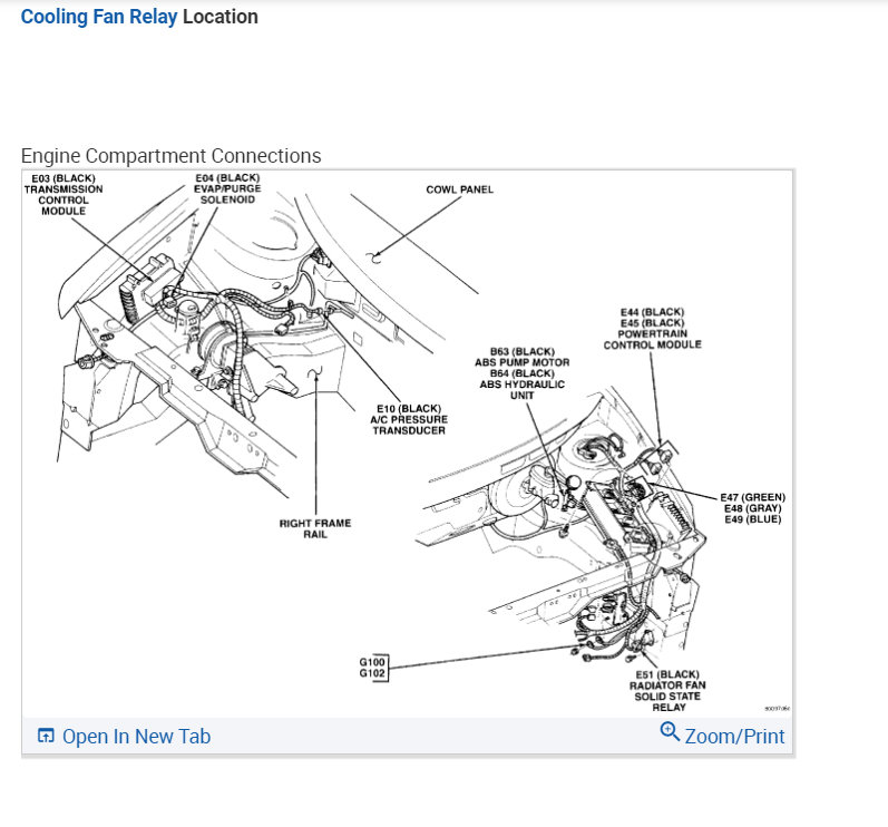

FYI replaced radiator, thermostats and the fan assemble. The vehicle was still getting hot, I found fans still not coming on all the time. So, I wired it so fans come on all the time once the key is activated, could this be wrong?
Aug 10, 2022 at 8:47 PM

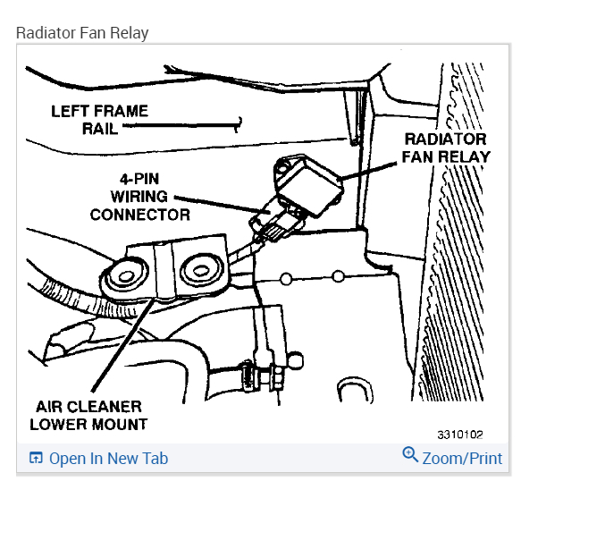

This sounds like two problems, first the fan control relay goes out and causes the fans to come on all the time, it is solid state so you will need to replace it here is the location in the diagrams below. Next for the overheating have you checked the coolant level? If so, you could have a blown head gasket. I would go over these guides to see if they can help us find the problem:
