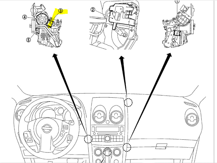

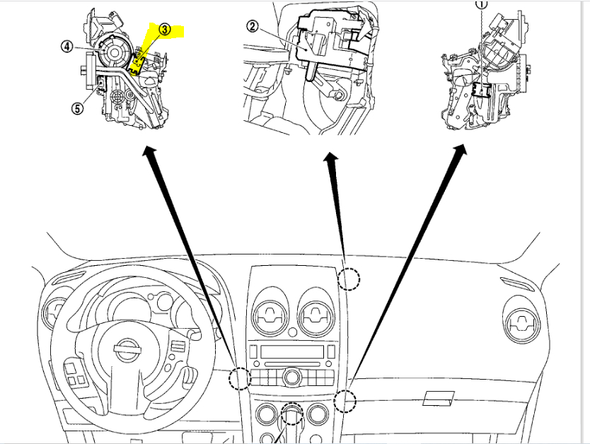

It sounds like something happened to the mode door actuator or the ductwork. When you replaced the motor, did everything go back together properly?
If you look below, I attached a pic of the mode door actuator and location. Did you take anything apart in that area?

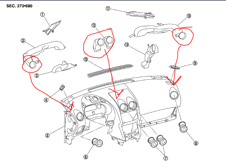

Also, I included an exploded view of the duct work and circled the ones for the vents. Check to make sure nothing has come apart.
Let me know what you find.
