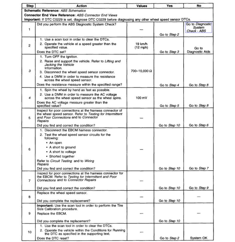

Okay, I attached the description and the flow charts for you to follow for the codes. They are mostly related to the sensor themselves and you will need to check all the sensors.
Circuit Description
As the wheel spins, the wheel speed sensor produces an AC signal. The EBCM uses the frequency of the AC signal to calculate the wheel speed.
Conditions for Running the DTC
C0221 and C0225
The ignition is ON.
C0222,C0223,C0226 and C0227
The vehicle speed is greater than 32 km/h (20 mph) when the brake is applied or 19 km/h (12 mph) when the brake is released.
Conditions for Setting the DTC
C0221 and C0225
The EBCM detects an open or shorted wheel speed sensor or wheel speed sensor circuit for 500 milliseconds.
C0222 and C0226
The corresponding wheel speed sensor signal is less than 6 km/h (4 mph) for 5 seconds, or 120 seconds in order to set both DTCs.
C0223 and C0227
The EBCM detects an erratic signal from the corresponding wheel speed sensor for 105 milliseconds.
Action Taken When the DTC Sets
C0221,C0225
If equipped, the following actions occur:
The EBCM disables the ABS/TCS.
The ABS indicator turns ON.
The TRACTION OFF indicator turns ON.
The DTC displays the SERVICE BRAKE SYSTEM message.
C0222,C0223,C0226,and C0227
The EBCM disables the ABS/TCS and may disable DRP. The ABS indicator turns ON.
The red Brake warning indicator may turn ON.
Conditions for Clearing the DTC
Repair the condition responsible for setting the DTC.
Use a scan tool in order to clear the DTC.
After the DTC is cleared and the ignition is ON, the ABS indicator may remain ON until the EBCM completes a power-up self-test. This test concludes when the vehicle reaches a speed greater than 13 km/h (8 mph) and the wheel speeds are verified by the EBCM.
Diagnostic Aids
Operating the vehicle on extremely rough terrain can set DTC C0223, C0227 or C0229 even if the system is functioning normally.
Thoroughly inspect connections or circuitry that may cause an intermittent malfunction.
If the customer's concern is that the ABS indicator is on only during humid conditions such as rain, snow or vehicle wash, thoroughly inspect the wheel speed sensor circuits for signs of water intrusion. Use the following procedure in order to help isolate the problem area:
1. Spray the suspected area with a 5 percent salt water solution.
2. Drive the vehicle at a speed greater than 19 km/h (12 mph) for at least 30 seconds. Repair or replace the suspect harness if the DTC sets.
Test Description
The numbers below refer to the step numbers on the diagnostic table.
3. Measure the resistance of the wheel speed sensor in order to determine if the sensor has a valid resistance value.
4. Ensures that the wheel speed sensor is generating a valid AC voltage output.

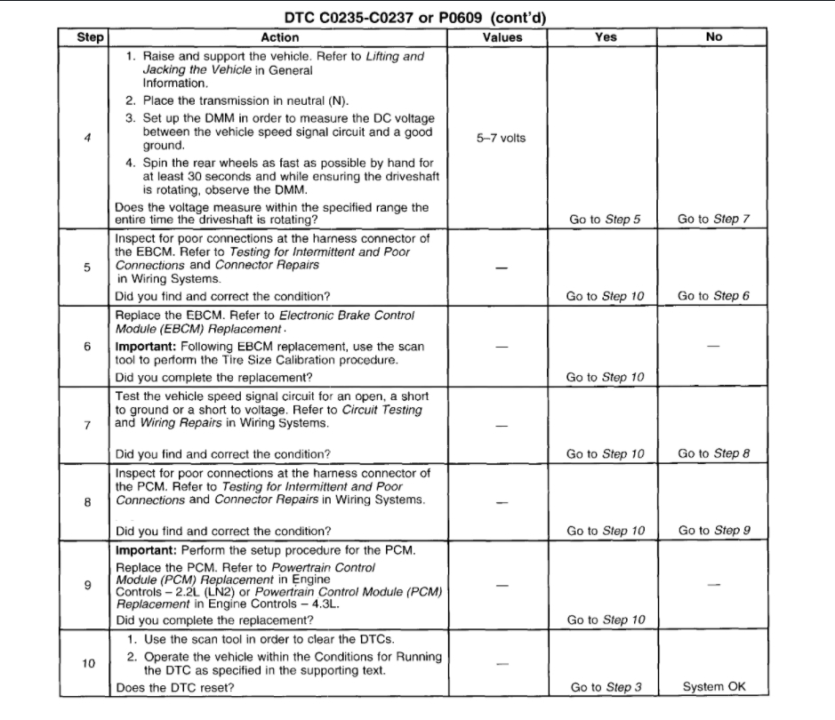

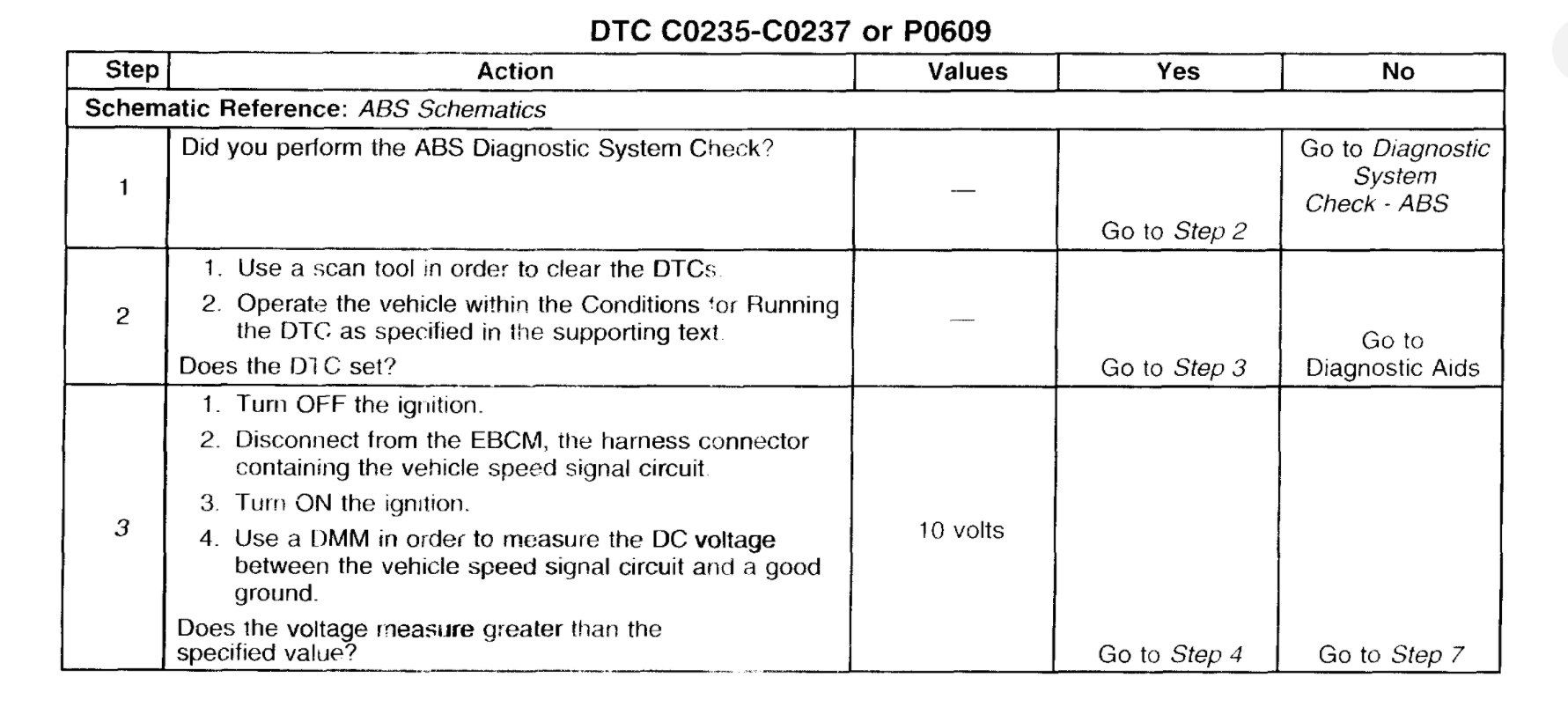

DTC C0235-C0237, C035-C037 or P0609
Circuit Description
The PCM converts the data from the vehicle speed sensor to a 128k pulses/mile signal. The EBCM uses the vehicle speed signal from the PCM in order to calculate the rear wheel speed.
C0235
The ignition is ON.
C0236 and C0237
The ignition is ON.
P1504
The ignition is ON.
The vehicle is not moving.
C0235
The EBCM detects low voltage or the vehicle speed signal circuit for 500 milliseconds.
C0236
The rear wheel speed signal is less than 6 km/h (4 mph) for 5 seconds, or 120 seconds in order to set multiple missing sensor signal DTCs.
C0237
The EBCM detects an erratic rear wheel speed signal for 105 milliseconds
P1504
The PCM detects low voltage on the vehicle speed signal circuit for 45 seconds
The EBCM disables the ABS/TCS/DRP.
The red brake warning indicator turns ON.
Diagnostic Aids
Thoroughly inspect connections or circuitry that may cause an intermittent malfunction. Refer to Testing for Electrical Intermittents, Testing for Intermittent and Poor Connections, Wiring Repairs and Connector Repairs in Wiring Systems.
Test Description
3. This step tests for a voltage signal from the PCM.
4. This step tests for a missing or erratic vehicle speed signal from the PCM. An assistant may be required to perform this test
