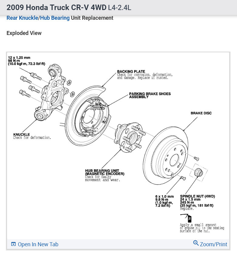

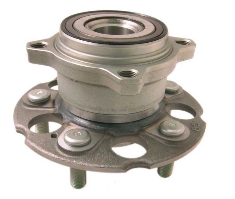

2. Axle shaft pulser defective. On vehicle visual inspection might not be accurate and it would be advisable to remove and recheck for roundness of the ring. The snapped chain could have caused some damage to the ring or it could be a damaged knuckle or bearing causing the pulser to turn eccentrically.
This would result in uneven pulsing signal.
