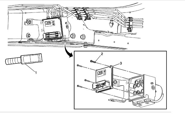

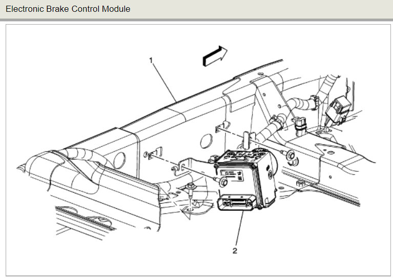

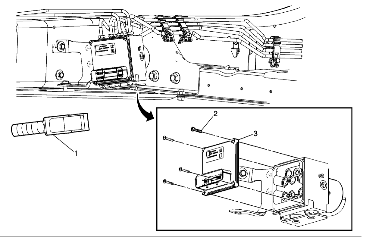

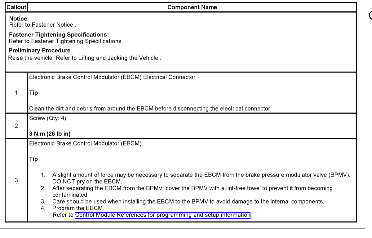

To me it sounds like the the ABS module has gone out. Here is a guide to show you what you are in for when changing the unit out.
https://www.2carpros.com/articles/how-to-replace-a-abs-controller
Here is how it will be on your car (below)
Nov 30, 2017 at 12:31 PM
