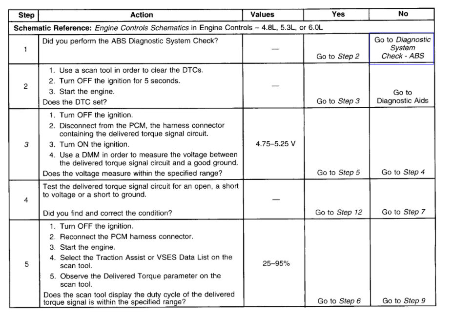

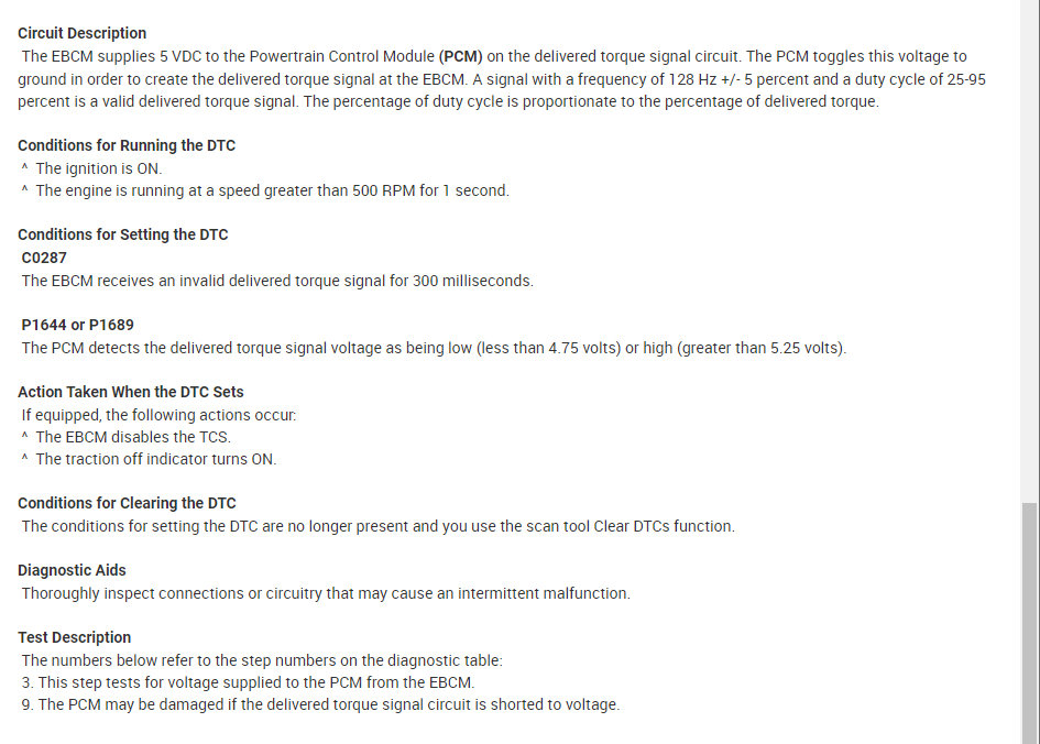

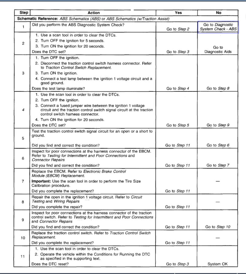

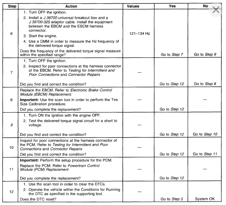

I was driving my SUV and it went into limp mode. I was throwing codes CO222, CO226, CO265. I replaced the wheel speed sensors and ABS computer. Now it is throwing codes CO287 and CO283. On the computer It also shows all the wheels are 5 mph when parked. The SUV still remains in limp mode.
