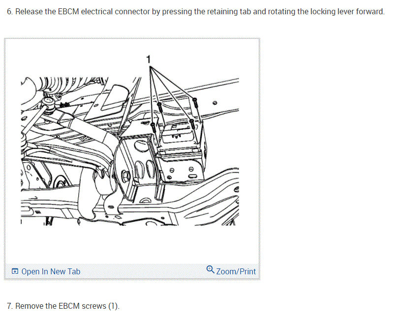

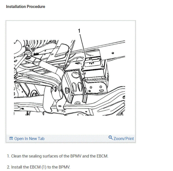

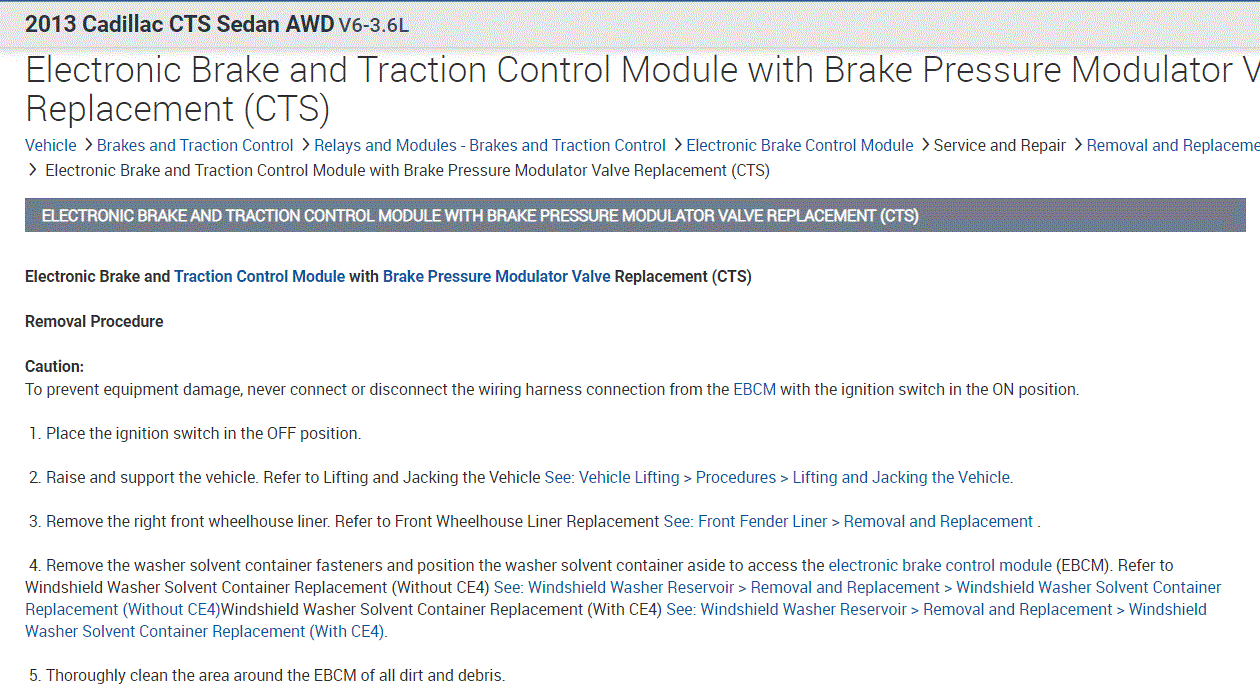

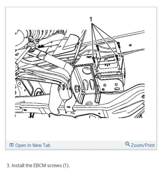

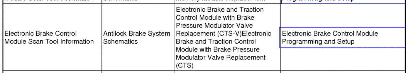

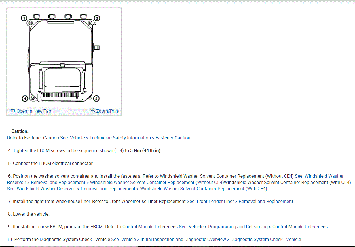

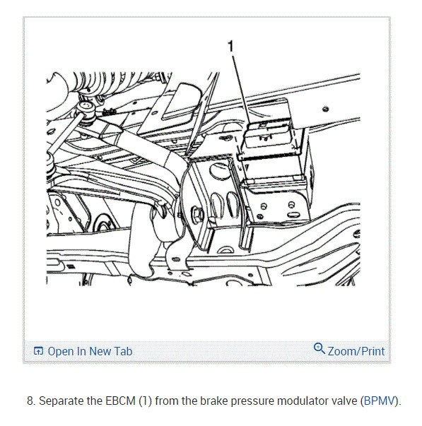

Replacing the ABS module on this vehicle is a little involved. However, if you take your time, you should be fine. The only concern is this. When the procedure is completed, the new module will need to be programmed to your vehicle. This will require a scan tool that can communicate with the module.
If you look at the attachments below, they include the directions and pictures specific to your vehicle for module replacement. Take your time and make sure to follow the directions when performing this.
I hope this helps. Let me know if you have other questions.
