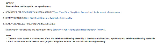

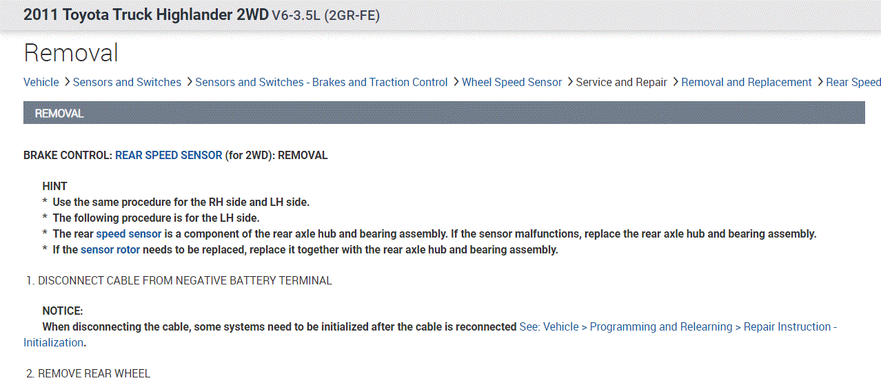

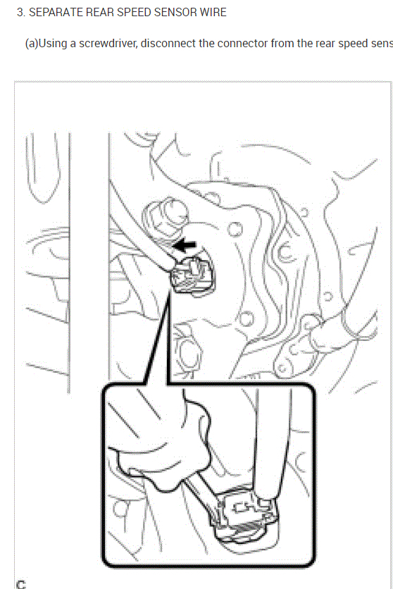

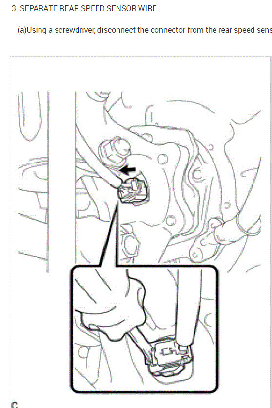

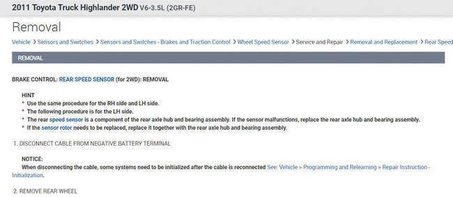

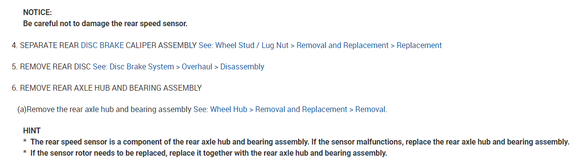

If you look at the attachments below, they provide the directions specific to your vehicle.
See pics below.
