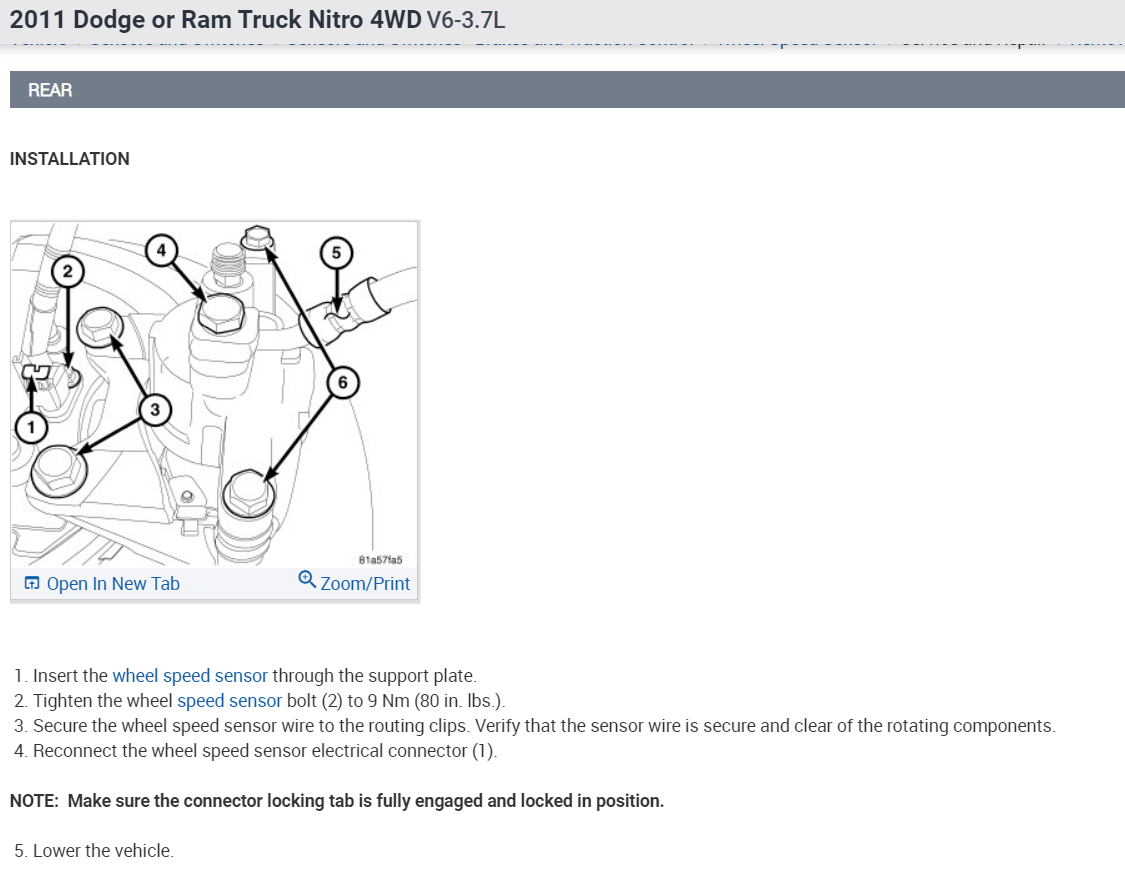

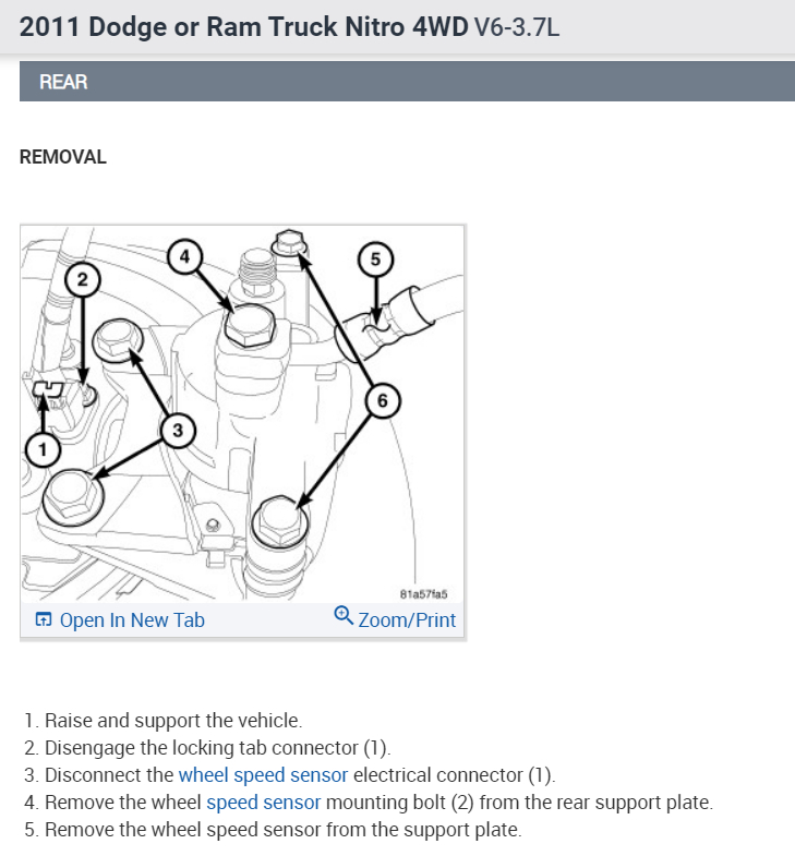

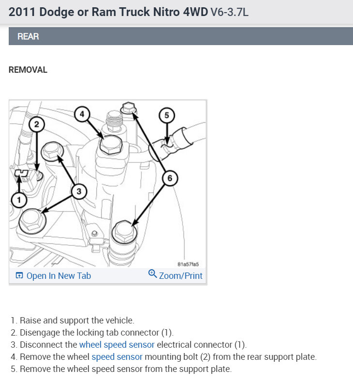

You can just do the one, and you are right if the problem follows the sensor the sensor is defective. Here are the instructions on how to change the sensor out correctly. Check out the images (below). Please let us know if you need anything else to get the problem fixed.
