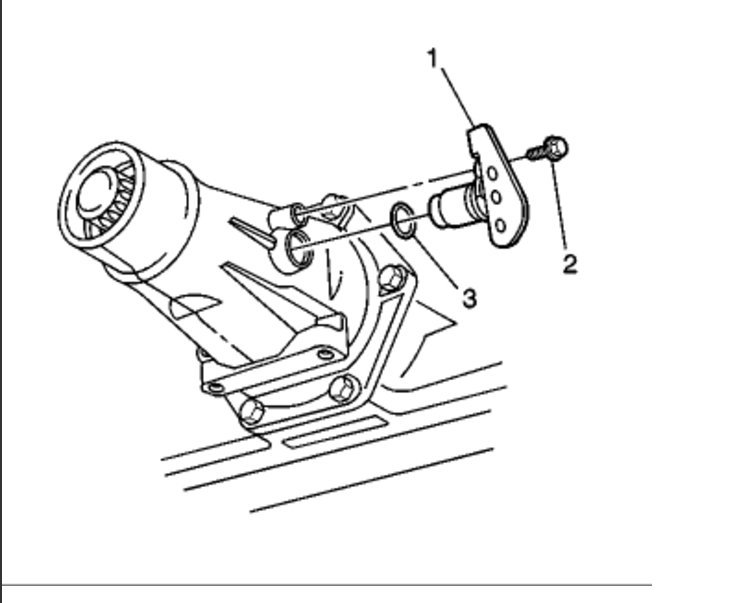

The speed sensor could cause all of these codes because the computer does not know how fast the car is traveling.
Here is a diagram for where the sensor is so you can get it fixed (below).
Yours will be in the transfer case near the rear drive shaft.
Then clear the codes and recheck.
