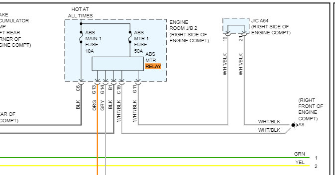

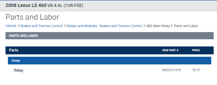

What I was able to find was part number 8826321010. I attached the parts/labor info below for your review.
As far as the relay, chances are two wouldn't fail at the same time. Here is a link that explains how to test one:
see pic below.

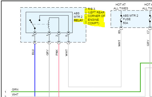

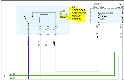

I just found it and you are correct. I didn't realize they had them in two different relay boxes. I had to page in 4 pages in the schematic to find the second one.
See pics below.

The part number I attached above is correct. The relay must be the same type because it is the only one listed.
