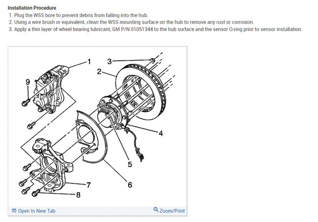

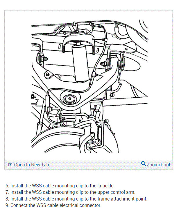

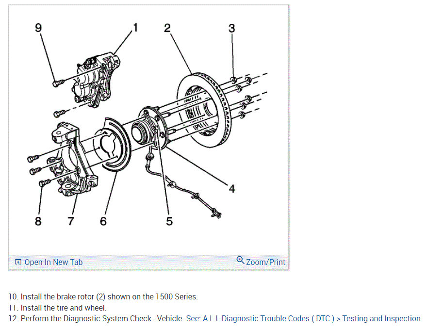

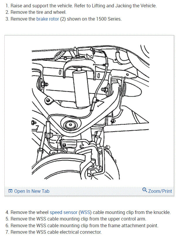

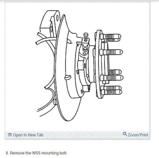

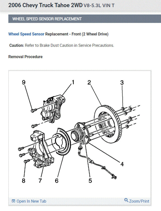

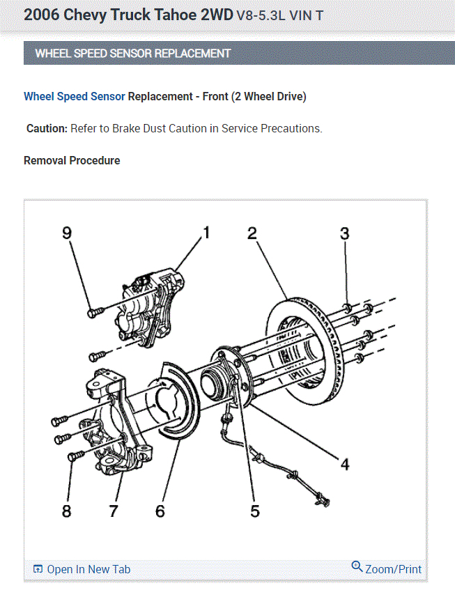

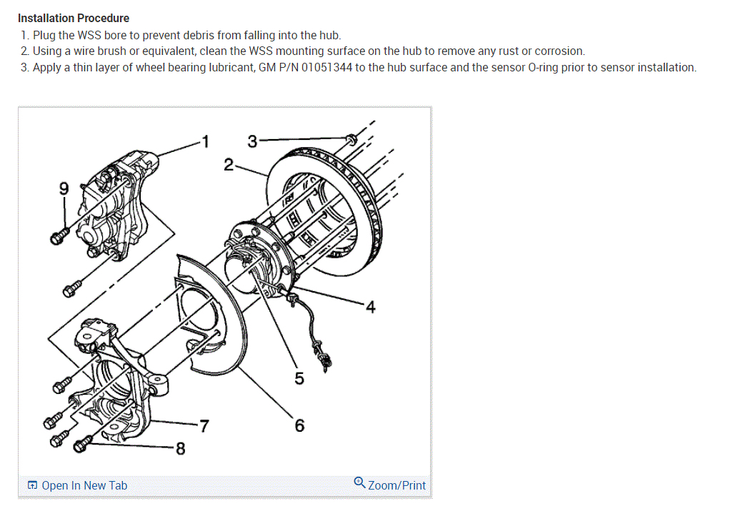

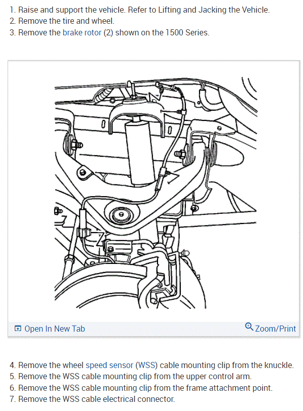

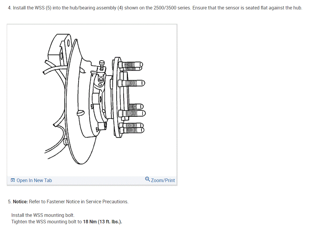

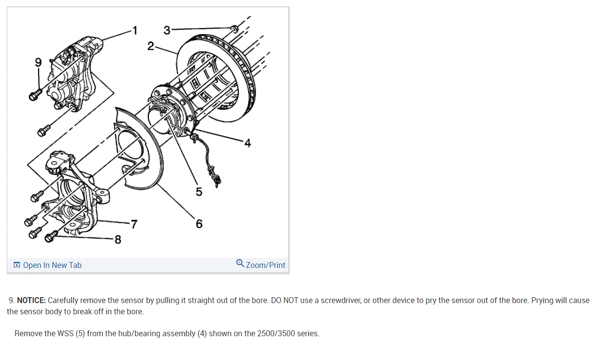

If you look at pics 1 - 8, they are the directions specific to your vehicle for replacing the wheel speed sensor.

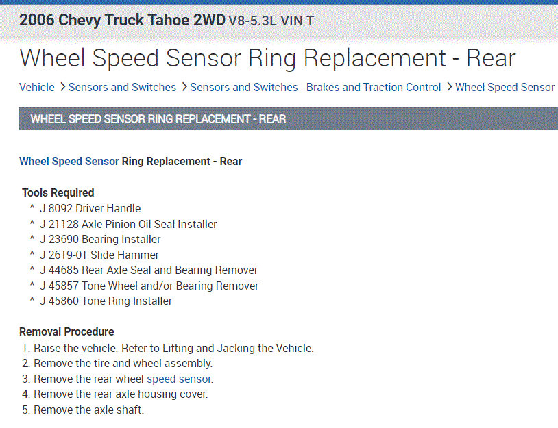

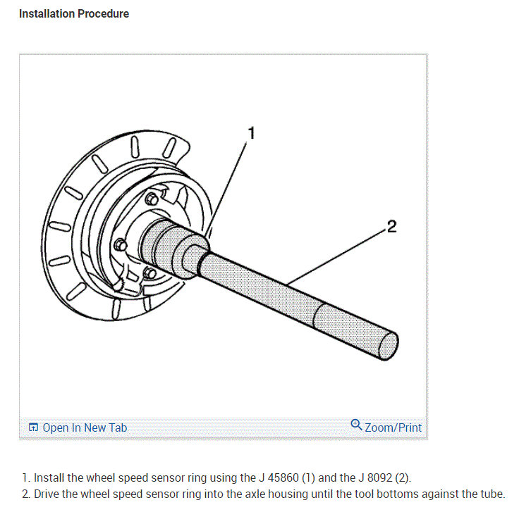

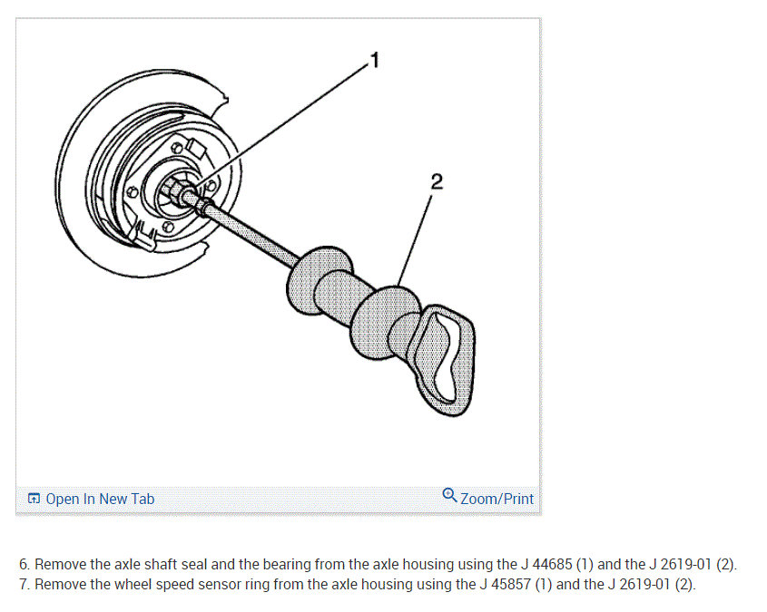

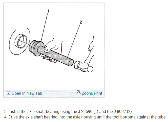

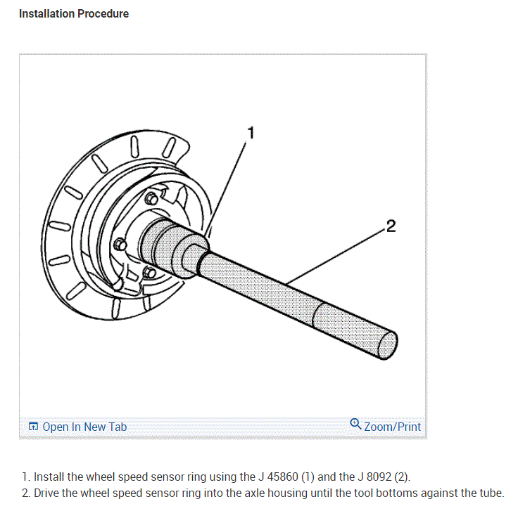

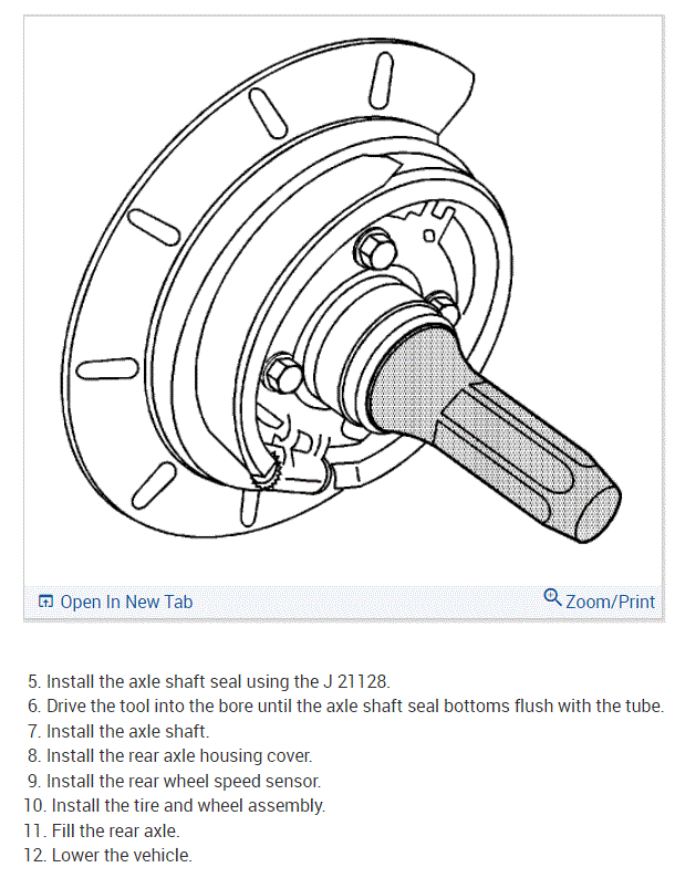

One other possibility is the rear toner ring has failed. That is the component that the sensor uses to determine speed. I attached the directions for replacing it as well. It will require the removal of the rear axle assembly.
Starting with pic 9 are the directions for sensor ring replacement.
