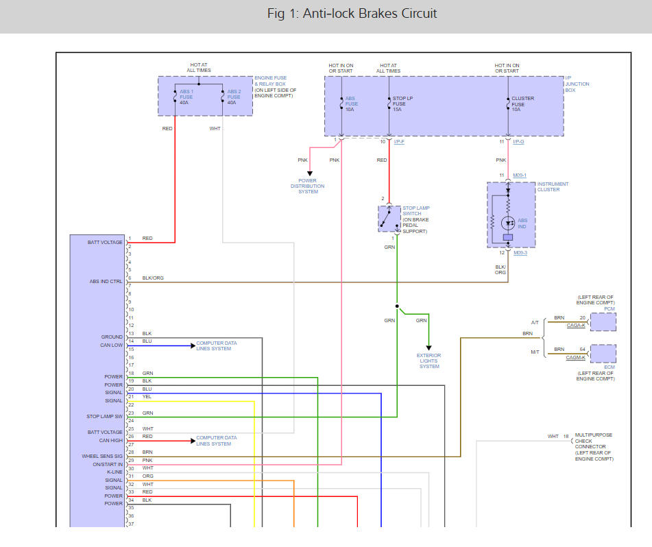

After running diagnostic tool, error in rear left sensor. I replaced the whole wheel hub with build in sensor. Still the same error. Cables have been checked and even the ABS pump with ECU. Dashboard light ABS is still on. After resetting still, the same error and light on. Other solutions please.
