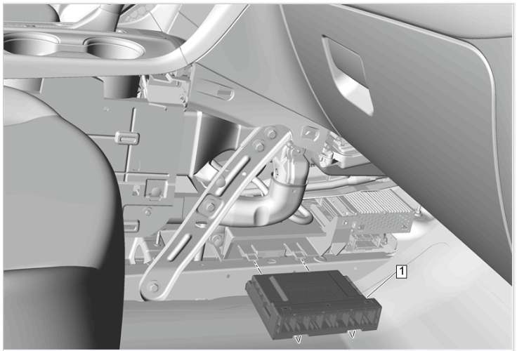

After a rain storm. Started car and traction control , stability control and parking brake maintenance lights were illuminated and solid. On the drivers info center it states:
Action Required: steering assist reduced. Drive with care.
Service: ESC
Service: AWD
Before the issue I changed front passenger caliper piston because old piston was stuck.
After the above issue started changed front rotors and pads due to warped rotors. Took it to the dealer and first they said it was the fuse box. I drove it for a week with the above issue and the car operated as “designed” after taking it to the dealer the car would have a what I can think of is a power interruption and the engine would shut off while in motion. Got the fuse box and changed it though the original problem persisted. Now the same shop is saying it’s a EBCM and possibly when I changed the brakes I must’ve pushed something into the abs module. Even though all I did was changed out the caliper piston since before the issue. Since the changed the car had no issues. Once the lights were showing on the dash is when I changed the rotors and brakes due to the warped rotors. U codes are being thrown:
EBCM
0151-00
0077-00
0131-00
PSCM
0077-00
0415-71
RDCCM
0151-00
0121-00
0077-00
0452-72
Service: ESC
Service: AWD
EBCM
0151-00
0077-00
0131-00
PSCM
0077-00
0415-71
RDCCM
0151-00
0121-00
0077-00
0452-72
