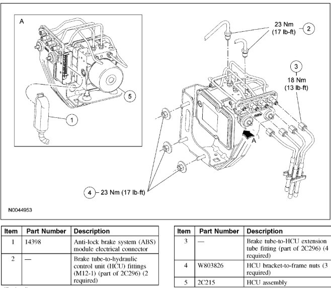

I recently purchased a used 2007 sport trac, upon trying to figure out the brakes I found the previous owner had cut all the brake lines off the abs, they are color coded but I cannot find anything to help me, there is a blue, red, white and green
Aug 15, 2025 at 5:49 PM
There is no information telling us which line goes to what wheel sorry, all we have is this diagram. Check out the images (below). Let us know how it goes
