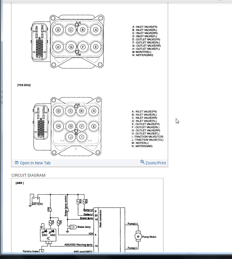

Will an (AWD) ABS component module operate in in my (FWD) front wheel drive car? having trouble locating a FWD ABS.

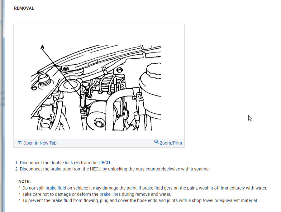

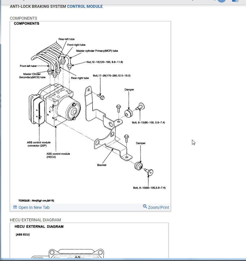

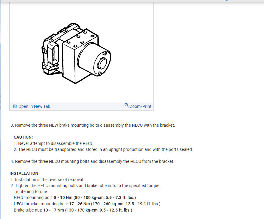

Here is a guide that will help with this. The ABS unit is a standard unit so it does not matter if it is AWD or not.
https://www.2carpros.com/articles/how-to-replace-a-abs-controller
Below is the process from the manual on how to replace this. Please run through this material and let us know if you have other questions. Thanks
