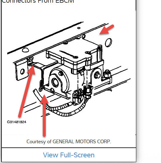

Good afternoon,

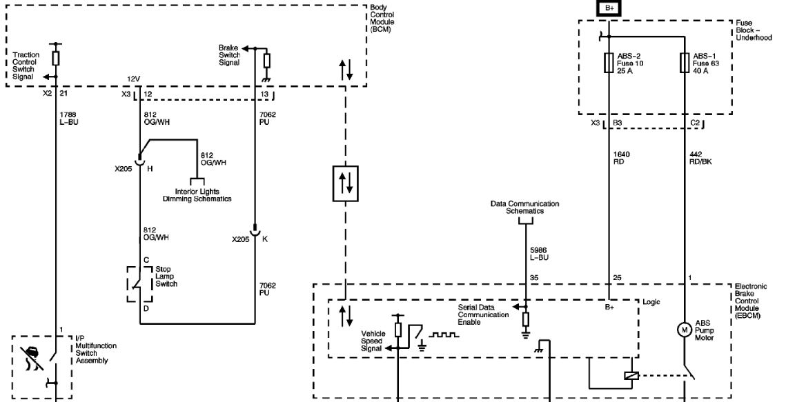

The first thing I would check is the powers to the ABS module. if you have powers to the module, good chance the module is bad. I attached a diagram for you to view and a video that show the module being replaced.
https://youtu.be/lUotkKXG9dY
Check out the diagrams (Below). Please let us know what you find.

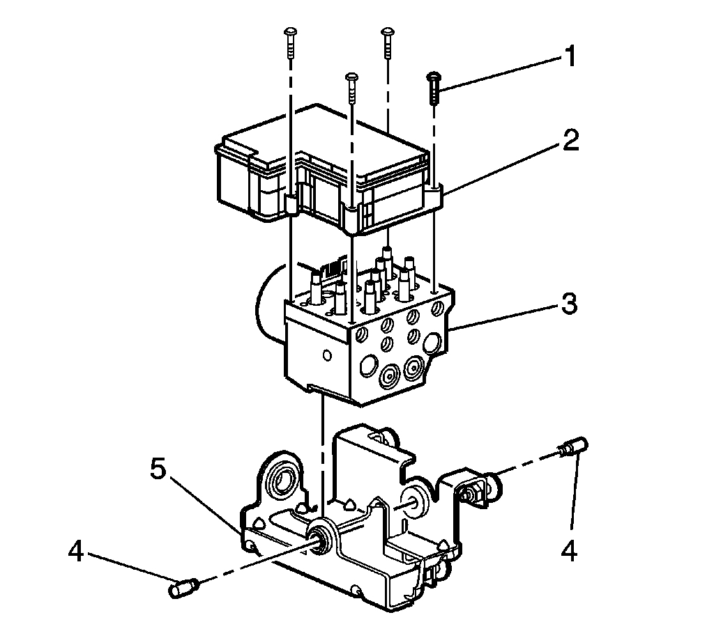

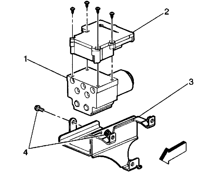

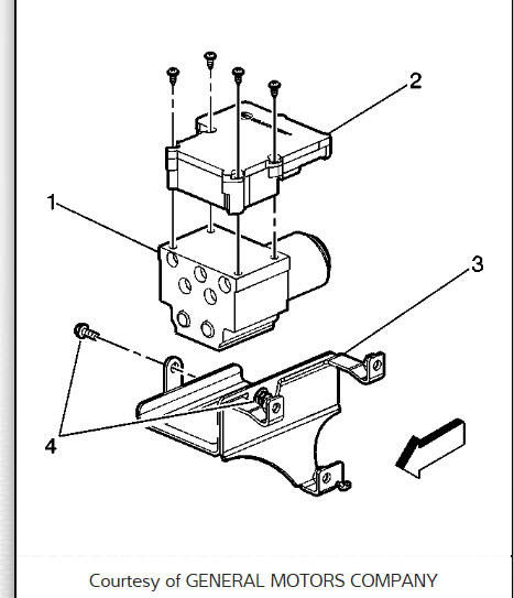

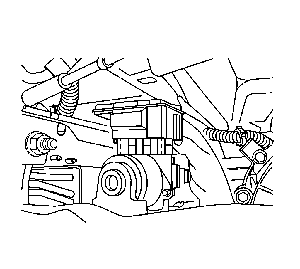

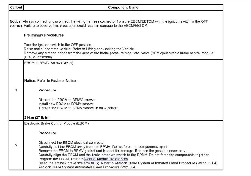

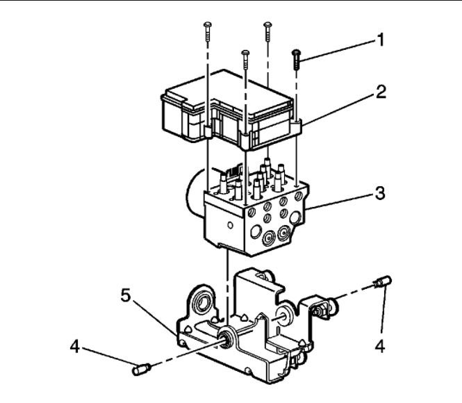

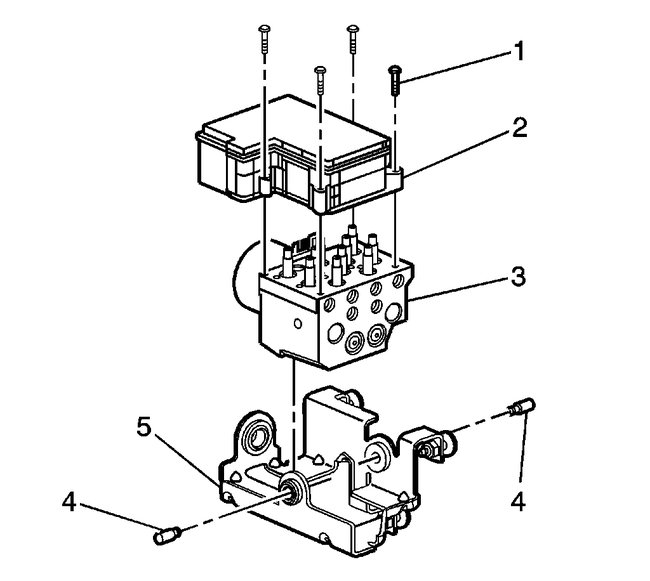

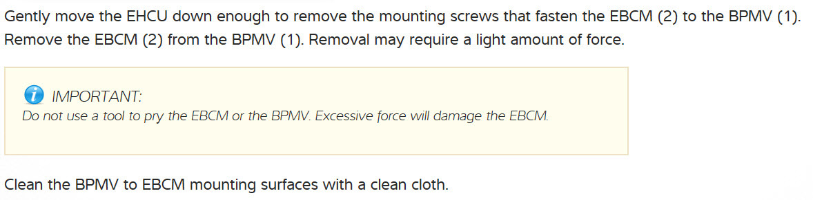

If you are only replacing the module, you are not getting into the hydraulics, so no. Here are the directions for replacement. The attached pictures correlate with these directions.
_____________________
Electronic Brake Control Module Replacement
Removal Procedure
Caution: Refer to Battery Disconnect Caution in Service Precaution.
Important: After installation, calibrate the new electronic brake control module (EBCM) to the tire size that is appropriate to the vehicle.
1. Disconnect the negative battery cable.
2. Raise and suitably support the vehicle.
3. Important: The area around the electric hydraulic control unit (EHCU) MUST be free from loose dirt to prevent contamination of disassembled ABS components.
Thoroughly wash all contaminants from around the EHCU.
4. Remove the mounting screws (1) that fasten the EBCM (2) to the brake pressure modulator valve (BPMV) (3).
5. Remove the EBCM from the BPMV. Removal may require a light amount of force.
6. Remove the EBCM from the vehicle.
7. Clean the BPMV to EBCM mounting surfaces with a clean cloth.
Installation Procedure
1. Important:
^ Do not reuse the old mounting screws. Always install new mounting screws with the new EBCM.
^ Do not use RTV or any other type of sealant on the EBCM gasket or mating surfaces.
Install the EBCM to the BPMV.
2. Notice: Refer to Fastener Notice in Service Precautions.
Install the new EBCM screws (1).
^ Tighten the screws to 5 Nm (39 inch lbs.) in an X-pattern.
3. Lower the vehicle.
4. Connect the negative battery cable.
5. If a new EBCM was installed, the EBCM must be programmed.
6. Turn the ignition to the ON position. DO NOT start the engine.
7. Perform the Diagnostic System Check
_______________________________________________
I hope this helps. Let me know if you have other questions.

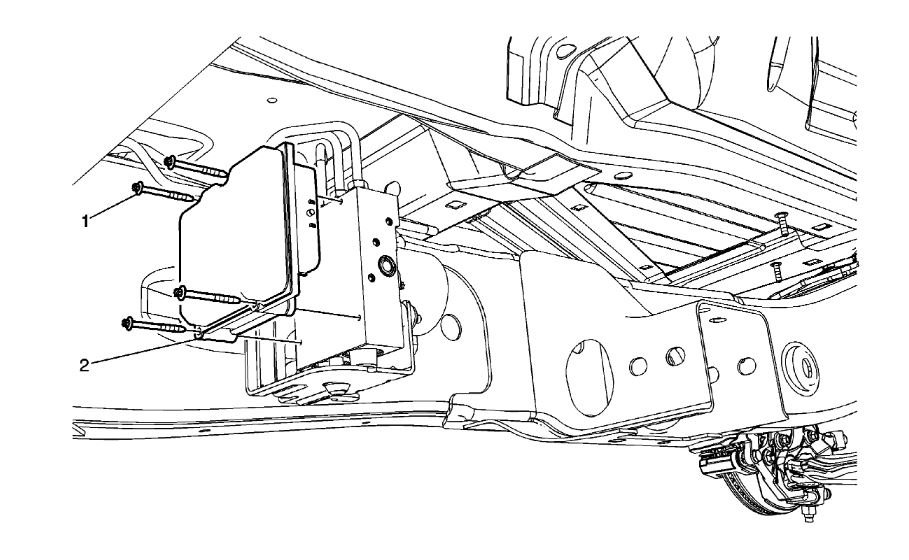

AUSTINHELMS10
I’ve tried removing the 4 torx bolts to remove it so you could match it to another module. But one of the back torx bolts seems to be stripped out and I can’t get anything to it. Please help!!!
Feb 23, 2021 at 9:15 AM (Merged)
Good morning,
You will need to get a sharp chisel and a hammer and try to knock the bolt loose in the counterclockwise direction.
If that does not work, you will need to cut the head off and remove the bolt after the module is removed.
https://www.2carpros.com/articles/how-to-replace-a-abs-controller
AUSTINHELMS10
The gap between the module and under the cab is not much. Are you sure this is possible?

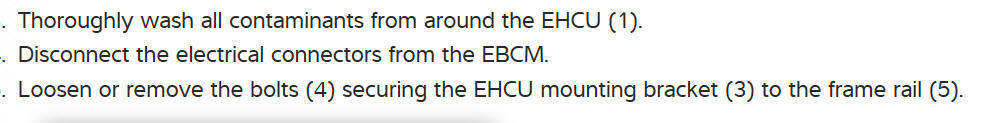

You will have to remove the bracket and hydraulic unit together and perform this on the bench if there is not enough room.
Can you post some pictures for me? I would like to see what you see.

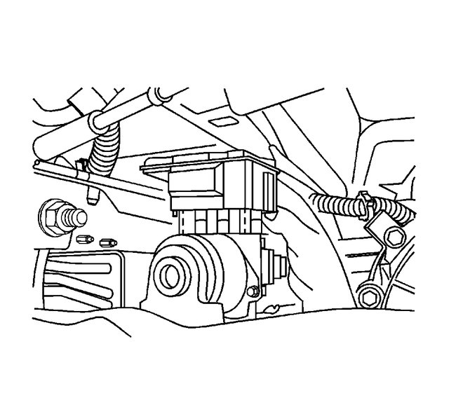

ROSENHAGEN
I have a z71 1500ls Silverado and can't get the abs module out due to no room for a small rachet.
Feb 23, 2021 at 9:16 AM (Merged)
HMAC300
  • 48,601 POSTS
the bracket that mounts the abs unit to the frame. Check out the diagrams (Below). Please let us know what happens.

I have the (4) bolts out of the Module What is the best way to get the two apart without prying?
HMAC300
  • 48,601 POSTS
Here is a video of the job being done
KENTUCKYCUB
I have already got the (4)bolts out,issue is how to get the EBCM apart from the EHCU without prying,would using a razor knife to cut the seal be practical
HMAC300
  • 48,601 POSTS
if you have cleaned around it then try using a rubber mallet or similar and tapping around it lightly to remove it.
KENTUCKYCUB
Thanks Hmac300 I got it ,I was a little hesitant about hammering around on it,thanks for your help.
