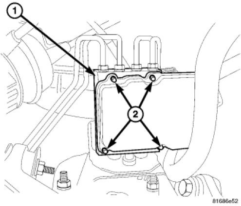

I have to be honest. I just read through the manual for replacement. It doesn't indicate that reprogramming is even needed. It does say to actuate it to make sure it works, but that is all that is listed.
Here are the actual directions. The attached pic correlates with both the removal and installation. The only thing not listed that I would recommend is to disconnect the battery prior to working on this and don't reconnect it until the job is complete.

NOTE: ABM module can be removed without removing the HCU unit.
see pic 1
1. Remove the left front tire and wheel assembly.
2. Disconnect the electrical connector from the ABM module.
3. Remove the module mounting screws (2).
4. Remove the module from the HCU (1) on ESP vehicles be careful not to damage the pressure sensor or not to touch the sensor terminals on the HCU side or the contact pads on the ABM side when removing the ABM.

See pic 1 (again)
1. Position the module on the HCU on ESP vehicles be careful not to damage the pressure sensor or not to touch the sensor terminals on the HCU side or the contact pads on the ABM side when installing the ABM.
2. Install the mounting screws (2) and tighten to 2.5 Nm (22 in. lbs).
3. Perform the ABS verification test with a scan tool.
