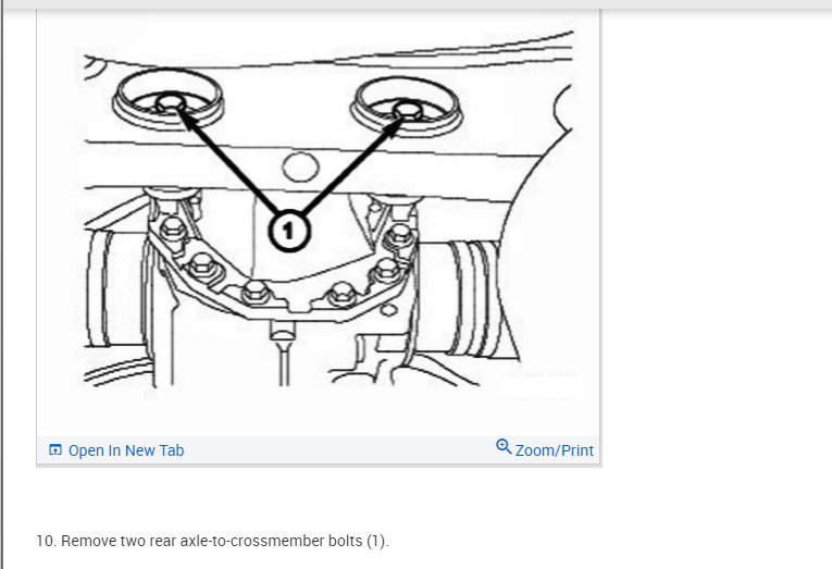

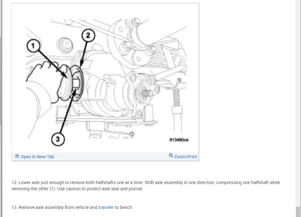

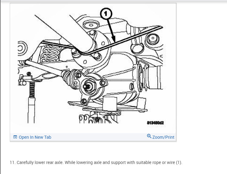

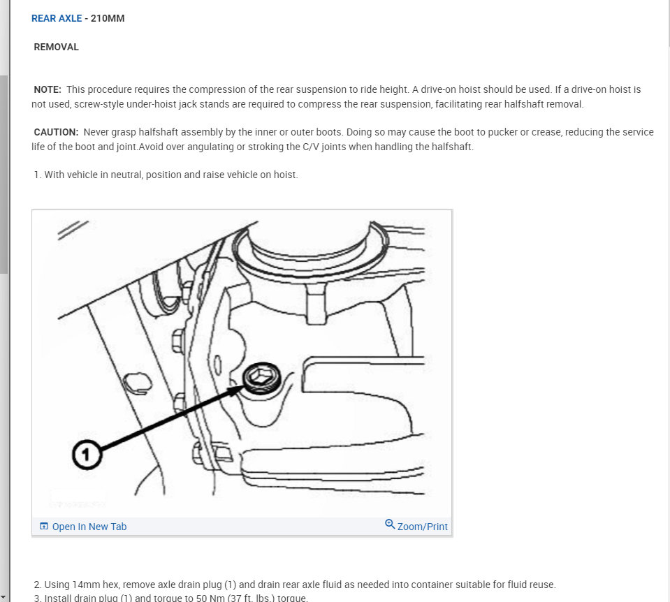

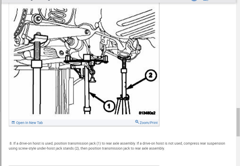

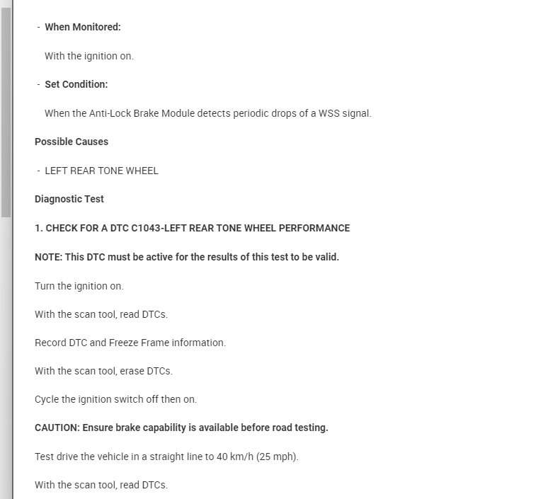

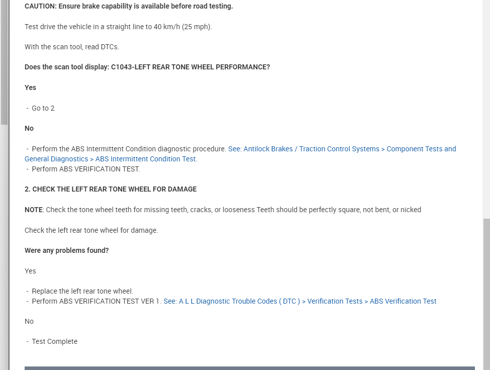

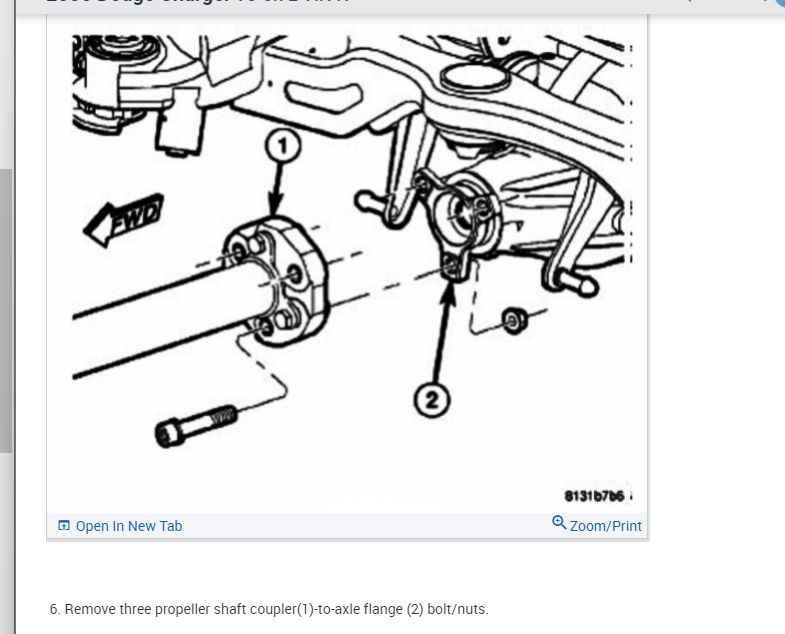

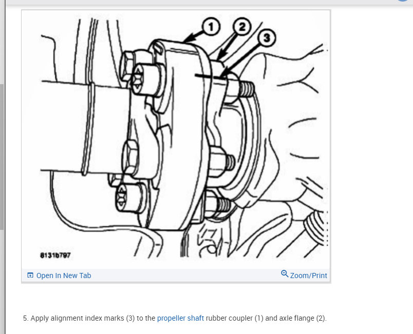

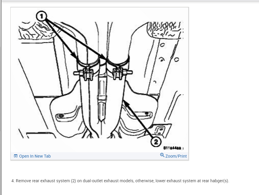

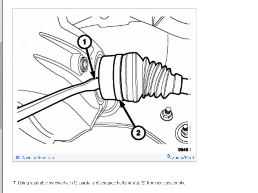

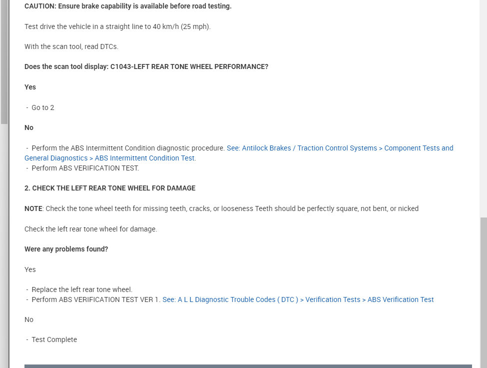

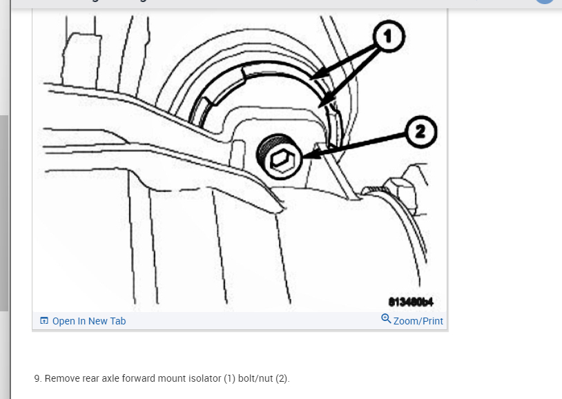

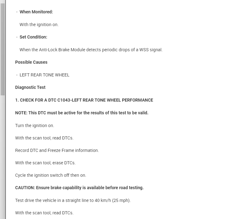

This code is specific to the tone wheel and not the sensor. So, this means we need to go to the left rear tone wheel and inspect it for cracks or broken teeth.
https://www.2carpros.com/articles/abs-wheel-speed-sensor-test
More than likely the axle will need to be removed in order to replace the tone wheel or just the axle all together. I attached the testing and the process for the rear axle below.
Please run through this and let us know what questions you have. Thanks

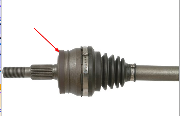

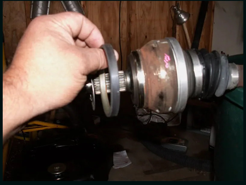

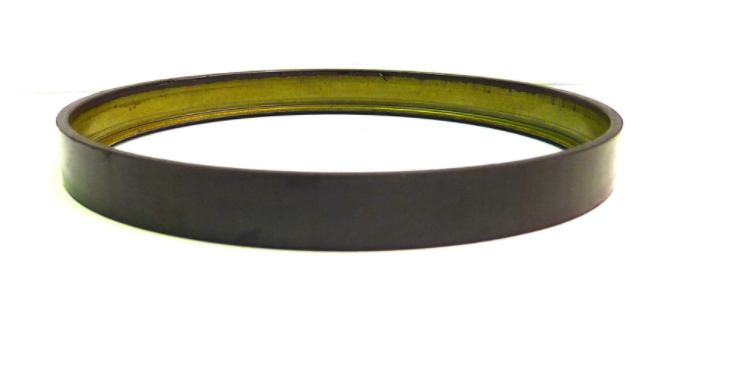

Sorry. I forgot that this was a year that they started using a relutor ring with a magnetic encoding ring.
Take a look below at these pictures. However, you do not need to replace the entire axle. There are many options out there for repair kits.

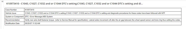

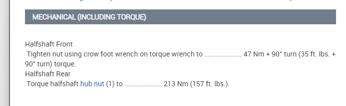

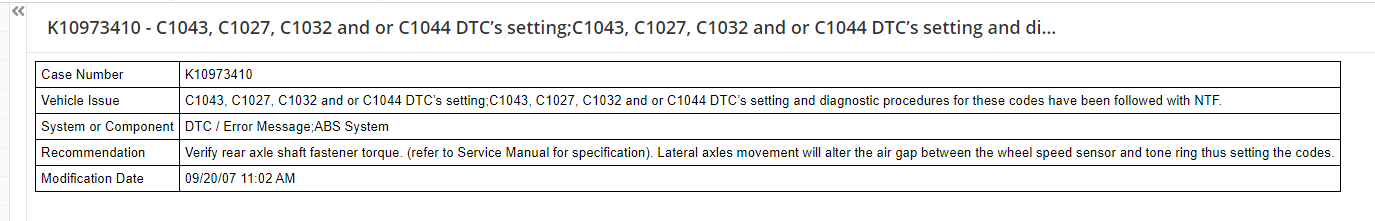

However, I am also attaching a case as well for this issue. If the axle nut is loose then it will cause this code. So, I would suggest checking this and making sure this is not the issue.
Please let us know what happens. Thanks

I already checked the axle nut it’s on tight, what should I do now. The lights come on for a while then back off for a while constantly.
Nov 3, 2021 at 7:09 PM
This code is pretty specific in the fact that the ABS does not like the signal it is getting from the speed sensor. It is able to tell that the signal from the tone wheel is not correct so more than likely it is just worn out or the air gap is not correct.
Based on what you have done, I would replace the ring and see what happens. Normally you can see something wrong with it, but you may have to remove it and if you are going that far, I would just replace it.

We don't have a process for this on the manual because they say to just replace the axle assembly.
You need to remove the axle or at least get it loose and out of the knuckle so that you can pull the old one off. Then you need to press the new one onto the axle so it would be easiest if it were out of the vehicle.
Here is a video from a parts company that shows how to remove the axle on your vehicle:
https://youtu.be/JliFs_XLjt4
You can search this vehicle and how to replace the tone wheel and there are a few videos of people doing this in the vehicle, but I would remove it.
You are going to have to find something like a bearing race that will press the tone wheel on evenly. Don't use a hammer and tap it on because you will damage it.

The only way this would be related to the code is if the axle is moving around so the sensor is not picking up a clean signal. However, that is what that case that I attached earlier was talking about where you had to check the torque on the axle nut.
