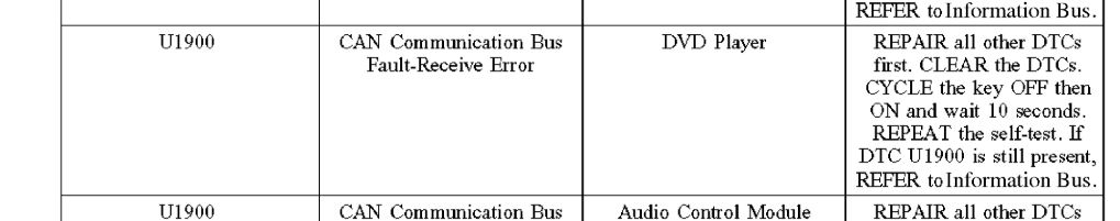

The 1900 code is for the DVD player.

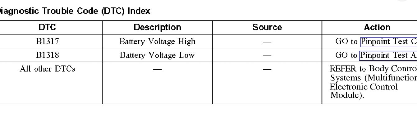

The 1318 is for the charging system. This could be a bad alternator, wiring or a failed PCM.

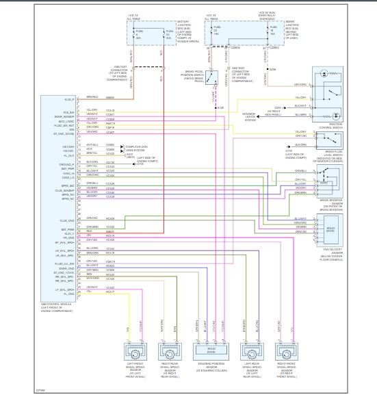

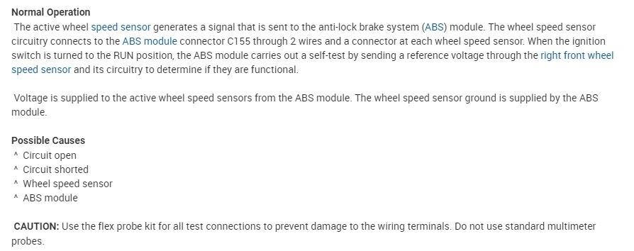

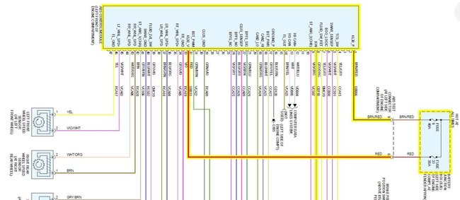

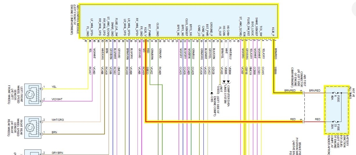

1676 is for low battery voltage to the ABS. Check all the fuses with a test light with the key on and verify voltage on both sides of the fuse. This is not a visual test, it is a voltage test.
