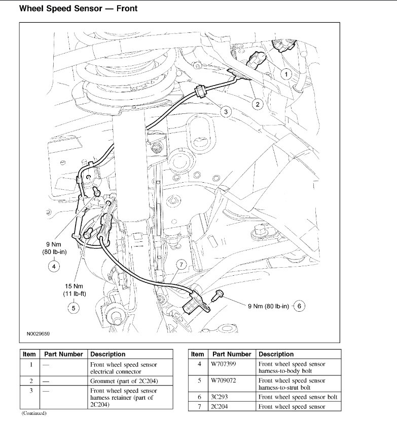

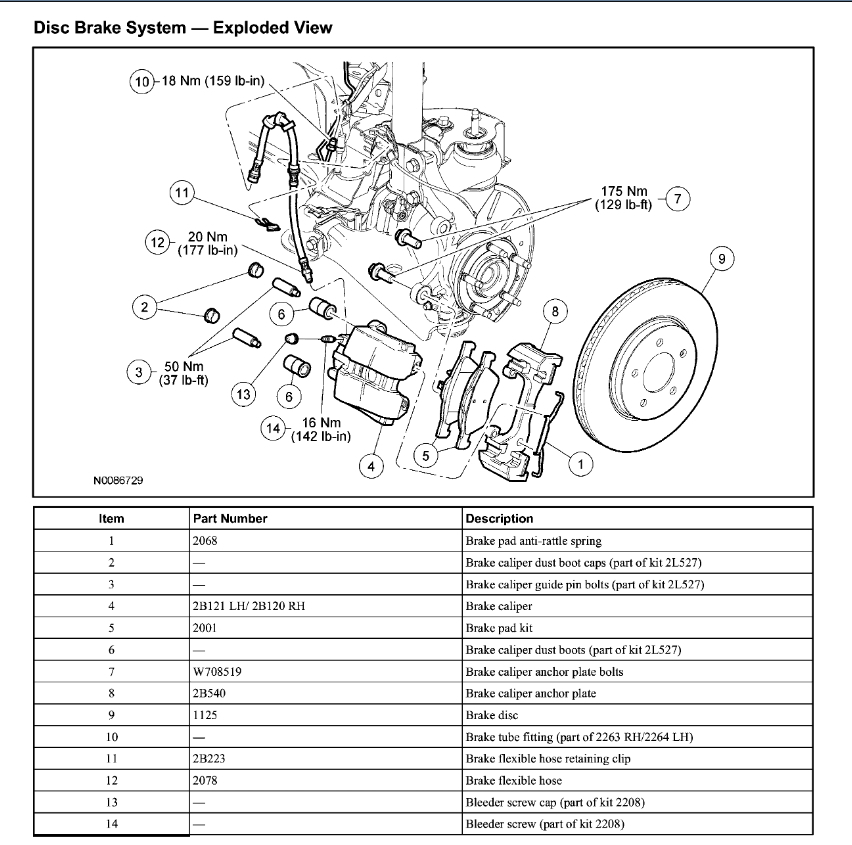

The brakes work perfectly until the lights come on, then after they turn on the car pulls to the side. Error being thrown is the front left traction control sensor, so I changed that out, and it didn't go away. I tried cycling the car a few times, and unplugging battery to reset, and didn't work.
