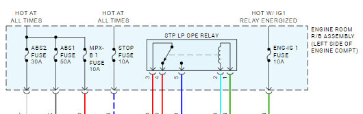

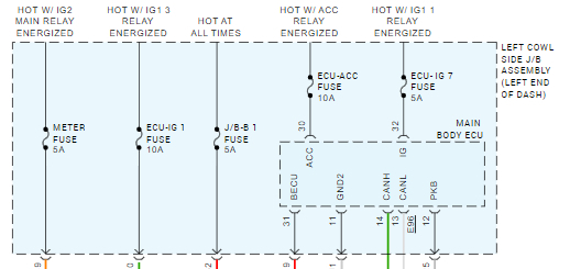

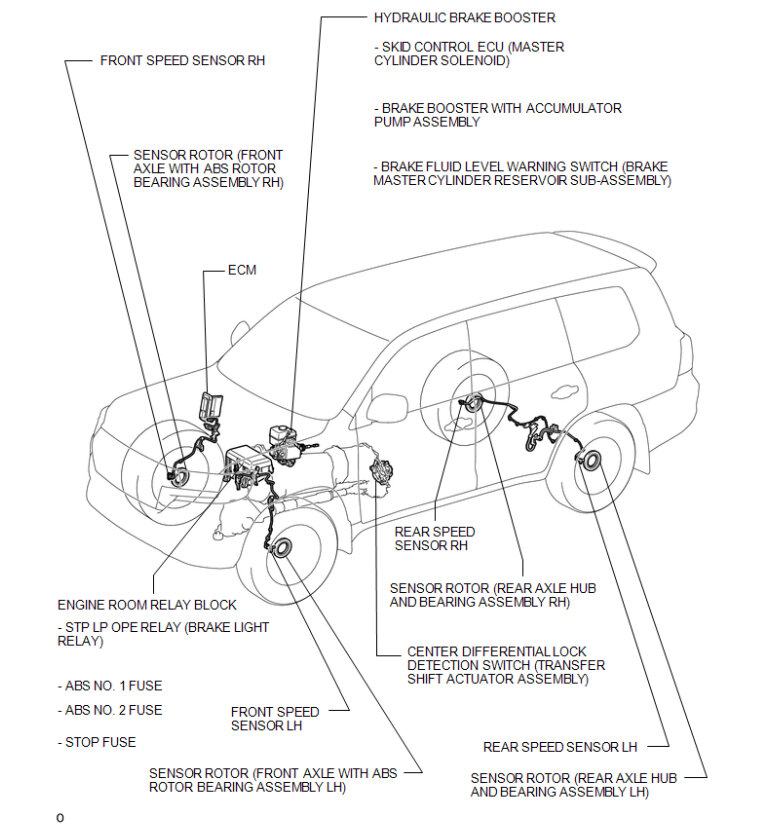

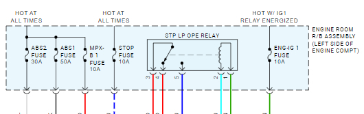

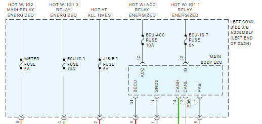

I would check the ABS fuses (12) to make sure none of them are blown, here is a guide to help and I have included the fuses that need to be checked on their location in the images below.
Check out the images (below). Let us know how it goes.
